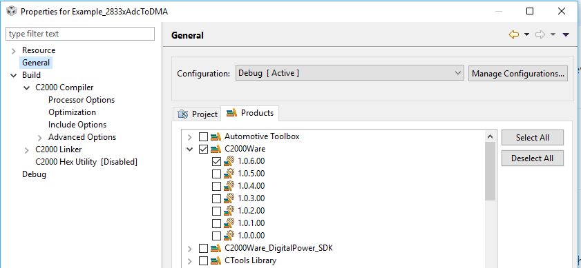

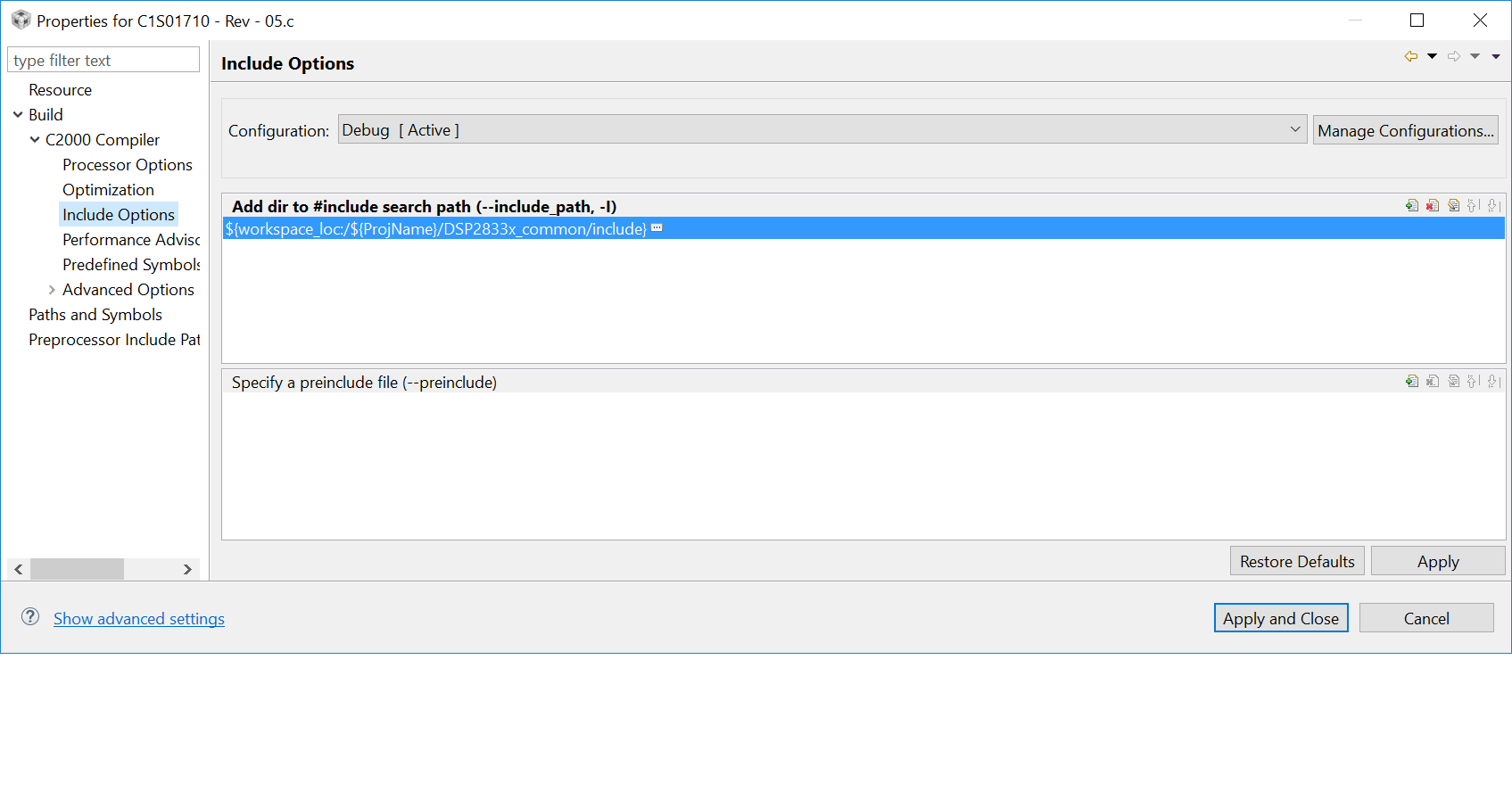

I have an older CCS 5.0 project that I am trying to get working in CCS 8.0
I am noticing that the includes files are creating compilation errors
There are 5 includes files, but I is only the top most include file that is creating the error
So I top file creates the error, and I put it on the bottom of the list, the new top file will then list he error.
I have created a screen shot below of the configuration
The image shows the include files are in a sub directory and also where the include files are called from.
I'm sure there is some link path that shows the relative location of includes files for the compiler but am not sure where to find it
  • I have tried adding the include here but no luck.. same error
  • The location you have shown in your screenshot is the correct place to add include paths for header files - Project Properties->Build->Compiler->Include Options, under --include_path. However, I don't see DSP2833x_Device.h in that directory as per your screenshot of the Project Explorer.
    Could you ensure that the paths to all the header files are specified here, then rebuild and let us know which errors remain?
  • Put this on your include list:
    C:\ti\C2000Ware\C2000Ware_1_00_06_00_Software\device_support\f2833x\headers\include
    referring to your C2000Ware product related path:

    I was able to fix the issue last week.  I'm not 100% sure where it got fixed.
    It seems like reinporting the project a different way may have did the trick  (as a CCS old version project)
