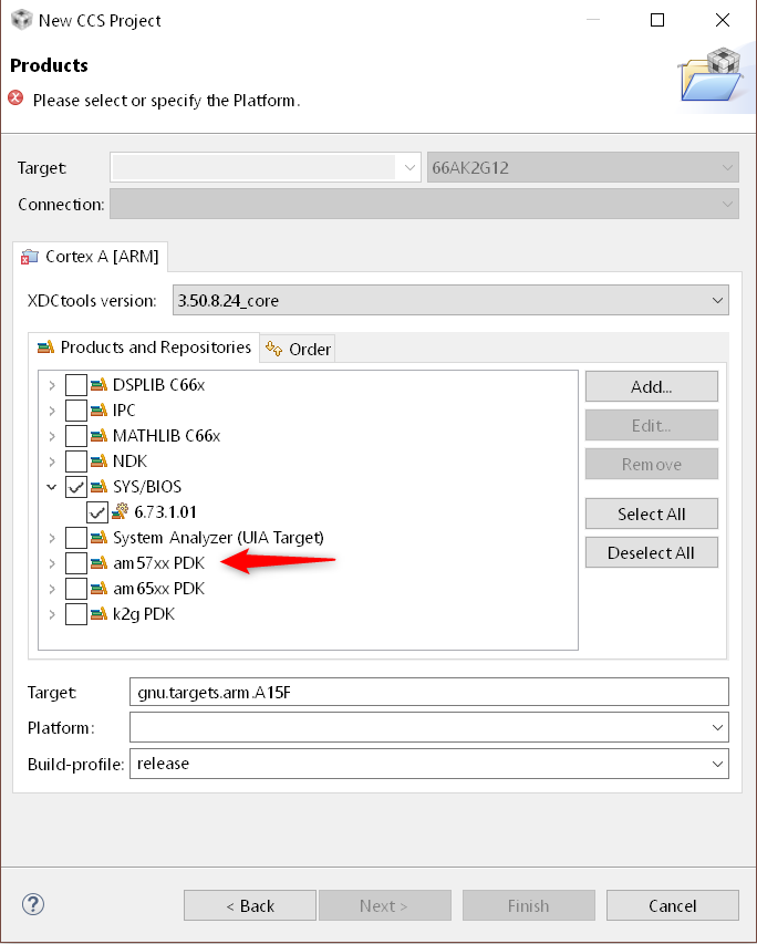

We tried several ways to get this working, such as
software-dl.ti.com/.../index_how_to_guides.html
Where we copied the idkAM571x project (it included the same files that PinMux outout)
But no luck, our board does not show up on page 2 when creating a new CCS project.
Project->New CCS project
 Target: AM571x - Cortex A15, AM57158
 ProjectName: Test10
 Compiler version: GNU v7.2.1 (Linaro)
 SYS/BIOS/GNU Target Examples/Typical
Click next -> our board does not show up among the "platforms"

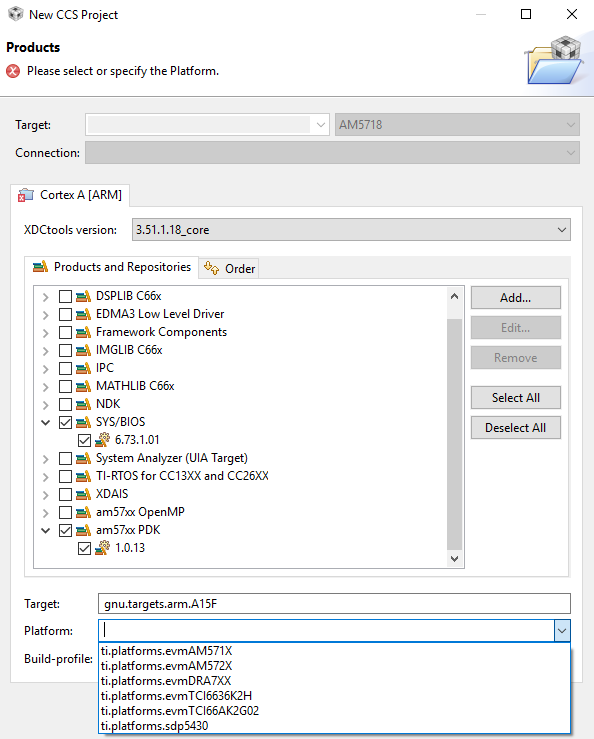

    We also assume that the lines
    ifeq ($(BOARD),$(filter $(BOARD), myCustomBoard))
      PLATFORM_XDC = "evmAM572XCustom"
    endif
    Makes it visible in the CCS gui when creating new (RTOS, SYS/BIOS) project, that is, even if our board/package is using 'myCustomBoard' in file names and in makefiles it will be
    listed as 'evmAM572XCustom' in the GUI.

    already now it build without errors but does not show up in the CSS GUI
    Good to know you are able to make progress here. Just to clarify the update to the .xdc or .bld files will not show up in CCS GUI but will be recognized by the XDC tools setting when you build a BIOS project.  For this to take effect you will need to update the BIOS configuration file as shown below:
    /* Load the Board package and set the board name */
    var Board = xdc.loadPackage('ti.board');
    Board.Settings.boardName = "customBoard";  // Was previously "idkAM572x"
    Is it correctly assumed that the system design of the TI board "construction" is that, whatever peripherals we have?
    we add the init call of the LLD to Board init function in idkAM571x.c and then the initializing code of the LLD to
    idkAM571x_lld_init. (I know, it seems to be obvious but just to be sure)

  • Stephen,
    The way the RTSC BIOS build works. The XDCtools looks for modules in the .cfg file in the package repositories that you have specified in your project. Can you check and confirm the XDC Settings of the project and confirm PDK\ packages is added there as shown below:
    Rahul

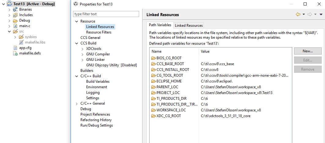

  • Hi
    My Project property looked like this
    It seems that the default setup of a Project in CCS is that it is not aware of anything beneath …./ti/...
    However when I try to add Another repostiry, the TI_PDK you suggested the CCS Environment is not aware of the PDK Environment variable you suggested
    But I added it manually (by typing it) like this
    But it did not find it anyway
    So it seems that it is neccessary to make CCS aware of TI_PDK_INSTALL_DIR (this is oddly, you could expect that the installation of PKG in the first place should have made TI_PDK_INSTALL_DIR aviable to CCS)
    Shall I reinstall the PDK package or manually add TI_PDK_INSTALL_DIR somewhere ?
  • Stefan,
    When you start with Processor SDK RTOS development, one of the first getting started steps is to discover processor SDK RTOS components  as described here:
    http://software-dl.ti.com/processor-sdk-rtos/esd/docs/latest/rtos/index_how_to_guides.html#overview
    When you complete this process, you will see the PDK being added to CCS Products (Windows->Preferences-> Code Composer Studio-> Products)
    This allows user to add this product to their project when creating a  new project and defines the MAcro in the linked resources as you can see in screenshot below:
    Rahul
  • Hi
    Our setup is similar to yours for the first steps but not on the last
    The first screen shot is the same as yours but the next ones are not
    The second screen shots shows how it look when we try to create a SYS/BIOS Project for the AM571X platform ARM A for the 5718
    As you can see, it does not show our board (ti.platforms.evm5718 was chosen just to be able to finish the Project setup)
    The third screenshot is the properties for the newly created Project.
    Even if screenshot 1 shows that it "knows" about am57xx, the Environment variable show up in screenshoot 3)
    Are we supposed to add this "COM_TI_PDK_INSTALL_DIR" somewhere ?
    Did we make any misstakes when installing the PDK package, shall we re install it?
  • Additional information
    After pressing the "Rediscover…." button in the CCS preferences, recreating a Project based on the ti.evm571xx and then added your suggestion
    The buildenvionment seems to found it, we could compile the Project without errors but we have not tested it yet, let us investigate it a Little more.
    Glad to know you are making progress. I suspected some issue with the setup as the variables get auto defined when the eclipse plugin for the PDK package is detected in CCS.
    I suggest that the follwoing is added to the "how to build custom board build description" you provided earlier
    • That the custom platform will not show up in the GUI, these are SYS/BIOS internal platforms
      If not, it will confude people that their board does not show up in the GUI
    Thanks for the suggestion. I will update the documentation to reflect this to avoid any confusion.
