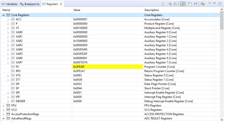

I would like to read out the registers of a running target (TMS320F28379S) in CCSv7 using the Registers view. However, when I connect to the target many of the registers display the value 0x00000000. I know for sure that these values should be different. One of the registers that is not displayed as all zeros is the program counter. The value of the program counter is changing so I know the target is indeed running. The Dual Code Security Module is not set up at this stage, so the target is unlocked.
Whenever I load the program via CCS (using an XDS100 emulator), the right values are actually displayed in the Registers view. But this is not what I want. I would like to see the registers of a target that is already running without having to progam it again.

    I tried connecting both in stop mode as in real-time mode. For real-time mode, I first cleared the DBGM bit of the ST1 register. I disabled the “halt the target on a connect” option and then enabled the Silicon Real-Time Mode (Polite). In the Registers view, I enabled the Continuous Refresh button. Is this the right approach?
    Also, for my application it is not necessary that time-critical interrupts are serviced during debugging. It also does not matter if the application is halted during debugging. I just would like to read out some registers (after initialization) without needing to load the application first. The value of the registers of interest does not change after initialization. This initialization is done in the beginning of the code, so if I halt the target after this I should read out the correct values. Should I use the real-time mode in this case?
    Attached you can find a screenshot of the Core Registers of the target which was already programmed and is simply connected to CCS. So the code was not loaded right before taking this screenshot.
    Thank you for the screenshot. I do not have enough knowledge on the device to confirm one way or another regarding the values of the registers. I will bring this thread to the attention of the C2000 device experts.

  • So you're saying that the values in the core registers (except PC) aren't changing even though you're executing code that is definitely writing to them? Even when you single step through code? Is this just affecting the core registers or do the peripheral registers display incorrectly as well?
    Can you go to Help->Installation Details in CCS and tell me what version of C2000 Device Support you have?

    I will give a little bit more context as I’m not sure that my previous post was clear.
    I have an application which uses TI-RTOS. One of the first things that is done in the code, is the initialization of the peripherals. This is done before the function ‘BIOS_start()’ is executed.
    For example, the EMIF is configured as follows (only three registers shown to illustrate):
    Emif1Regs_RCSR: 0x40000205
    Emif1Regs_ASYNC_WCCR: 0xF0000080
    Emif1Regs_SDRAM_CR: 0x00000620
    The value of these peripheral registers is not altered once the OS is started (this is BIOS_start() being executed).
    When I program the target and read out the registers using View->Registers, I correctly see the above values.
    However when I disconnect the target and re-connect it, then View-Registers shows:
    Emif1Regs_RCSR: 0x00000000
    Emif1Regs_ASYNC_WCCR: 0x00000000
    Emif1Regs_SDRAM_CR: 0x00000000
    So my question is, how can I read out the registers without having to program the target again?
    The version of C2000 Device Support I have is: 4.2.2.0
    If you are using the default f28379s.gel startup GEL file, then this can be explained by the fact that the OnTargetConnect GEL callback function defined in the GEL function (which will get called when you connect to the target) has an action to reset the CPU (line 101). It is the CPU reset that is clearing the register values.
