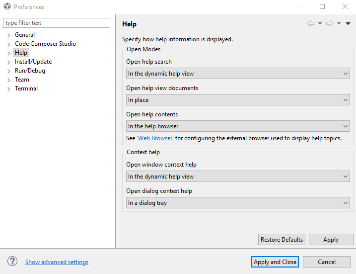

  • It appears that I do not have the "C/C++" submenu in my preferences dialog.
    I'm on Windows.
    Is there some way to turn off static code analysis for my workspace? Not sure how it would have turned on if you said it's off by default. I would rather not turn off the error message in case I actually need it.
  • You need to click on "Show advanced settings" at the bottom left to get to the "C/C++" options.
    "Is there some way to turn off static code analysis for my workspace? Not sure how it would have turned on if you said it's off by default. I would rather not turn off the error message in case I actually need it."
    Please note that this has nothing to do with building. The errors and warnings generated by the compiler have nothing to do with the code analysis feature. Static code analysis is a feature that is part of Eclipse but it often has issues when it comes to embedded C and C++ code. There are commercial vendors that provide much better tools for that if it is something you are interested in.
    Turning off code analysis will turn off that specific rule and all other rules. I would suggest just turning off that turn as it is giving false positives and leave the rest. The only way I have found to turn off analysis once it is enabled is to uncheck the rules.
    John
  • Okay, I found it after showing advanced settings. I completely missed the sentence telling me to do that in your previous reply.
    I'll stick with just disabling that one, thanks for your help!
