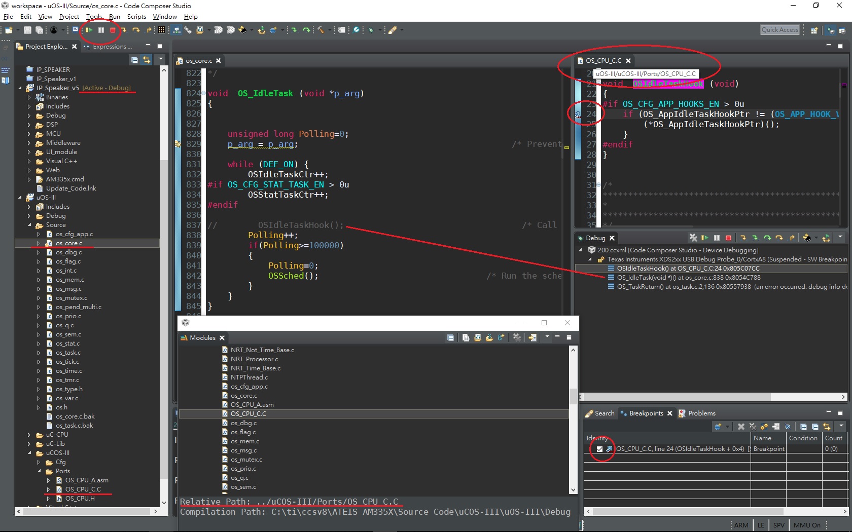

My desire action is to comment one statement in OS_CPU_C.c and rebuild my CCS project.
But unfortunately it is not working.
Here are my steps.
1. When program stopped at bp in OS_CPU_C.c, I opened CCS project module's view and confirmed that the OS_CPU_C.c file in module's view is the one that CCS referencing.

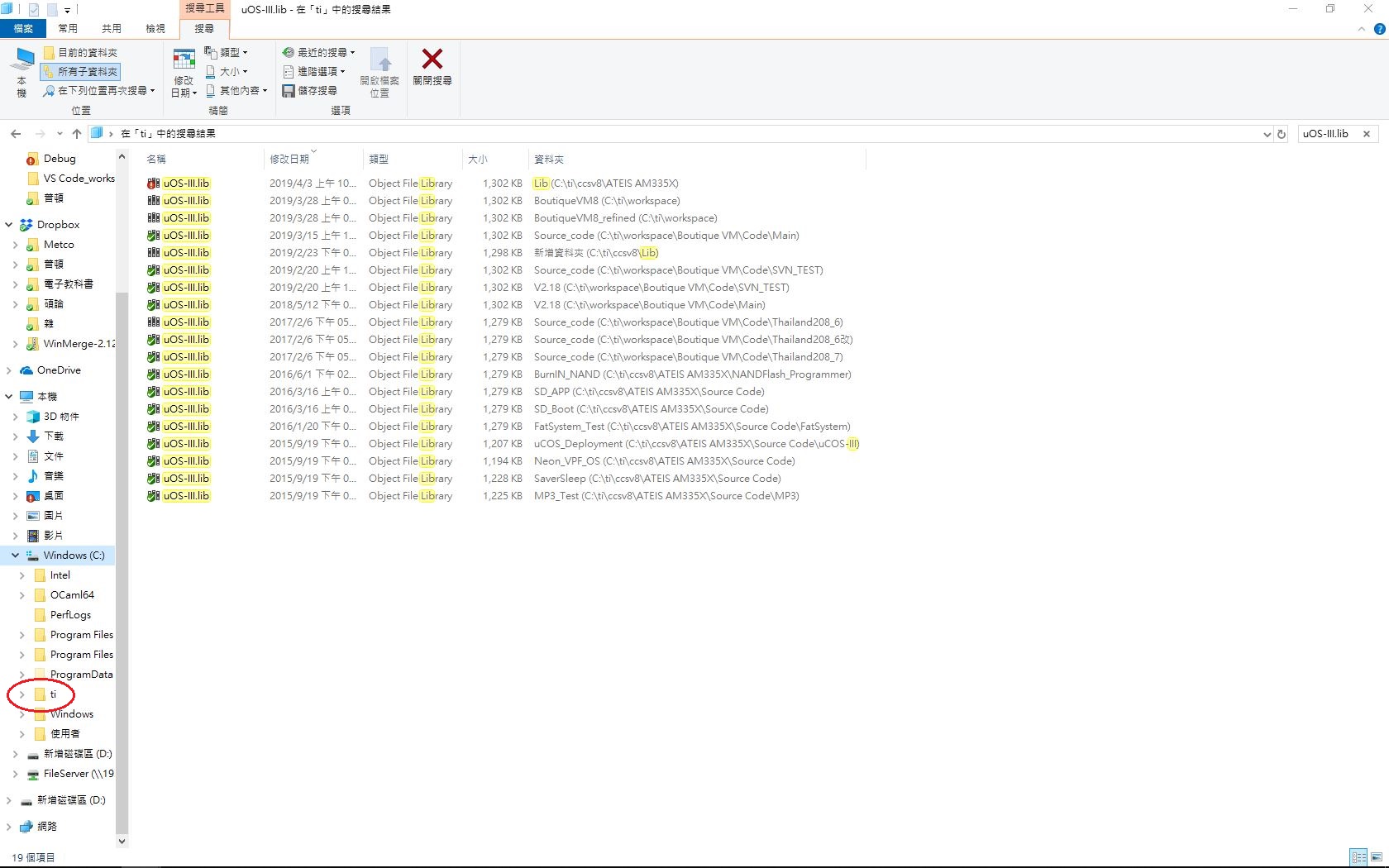

2. Check if this specific uOS-III library is the only one that project references. Unfortunately, there are so many uOS-III in file system.

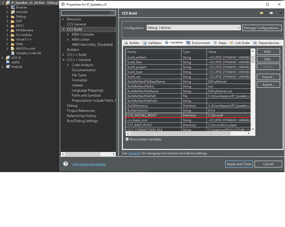

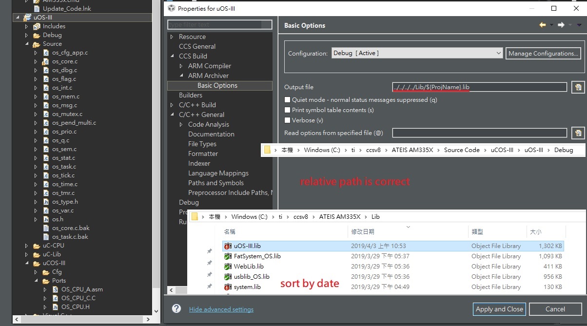

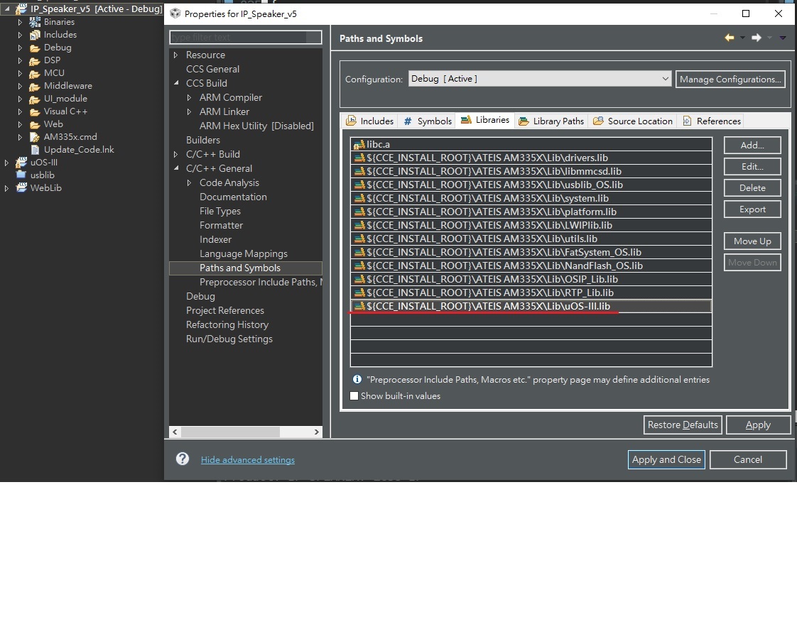

3. Make sure that project is referencing the library that I made a change on.
