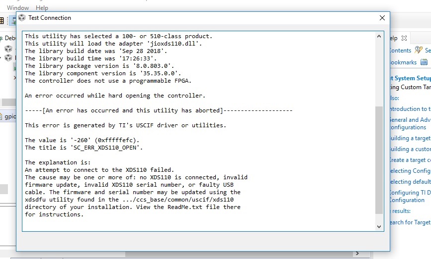

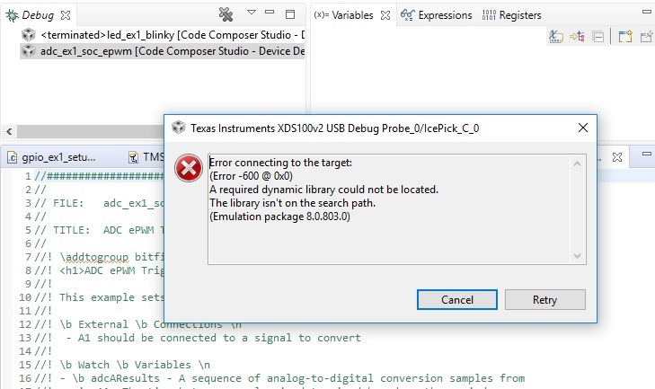

sir, im trying to do SFRA analysis. Programs like timer, hrpwm, led blinky are running properly.Error occurs in test connection when debugging adc (epwm) program in F280049C.
    The two errors are related to different Debug Probes. The first error indicates the utility can't find a XDS110 Debug Probe, but the background seems to indicate an active debug session is running. If that is the case, this is an expected scenario: close the debug session and try to run the Test Connection again.
    The second error is different. The adc_ex1_soc_epwm project is probably configured to use a XDS100v2 Debug Probe (the header of the error message dialog box) but the F280049C Launchpad uses a XDS110 Debug Probe. To correct this error, please modify the .ccxml file under the directory targetConfigs of the ADC project.
