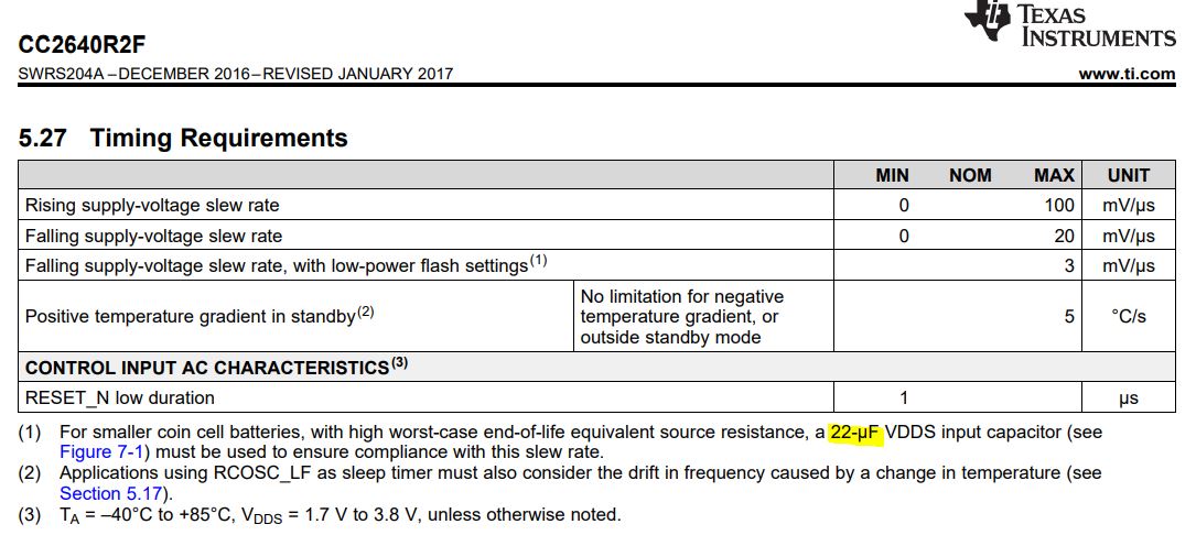

CC2640R2F frequently operates Flash, is it possible for the product to crash?At present, CC2640R2F has a 2% probability of failure. Currently, panasonic CR2016 is used for power supply.
Part Number: CC2640R2F
I cannot find a specification or limit in the datasheet that would suggest that in-system Flash programming is limited to a subset of the operating voltage. Is the device connected directly to the battery? How much does voltage drop during the application and flash operation?
