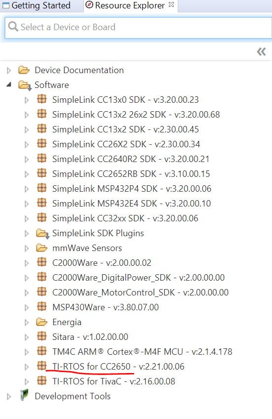

I don't have it listed in TI Resource Explorer. Only TI-RTOS for the CC2650 is. I've installed CCS9.1 and CCS7.4, same.
Hi Gabriela,
There is no SimpleLink SDK for the CC2650. It starts from the CC2640R2F to all our newer parts (CC13x2, CC26x2 etc).
You can find the BLE Stack for the CC2640/CC2650 products here under BLE Stack 2.2.2: http://www.ti.com/tool/BLE-STACK
Hello Evan, thank you for your response, this is my first dive into the TI mcu ecosystem, coming from Arduino. Please forgive me if these are obvious questions.
I have the BLE 2.2.2 stack installed.
Can I use CC2640R2F examples, blink, hello world, that sort of thing w/ the CC2650?
Essentially, I'm looking for some example code as a jumping off point to get familiar with CCS and its compiler.
CC2640/50 examples will not work on CC2640R2F and the same applies going the other way around.
To use the CC2650/40, use the BLE Stack 2.2.2.
To use CC2640R2F, use the SimpleLink CC2640R2F SDK.
