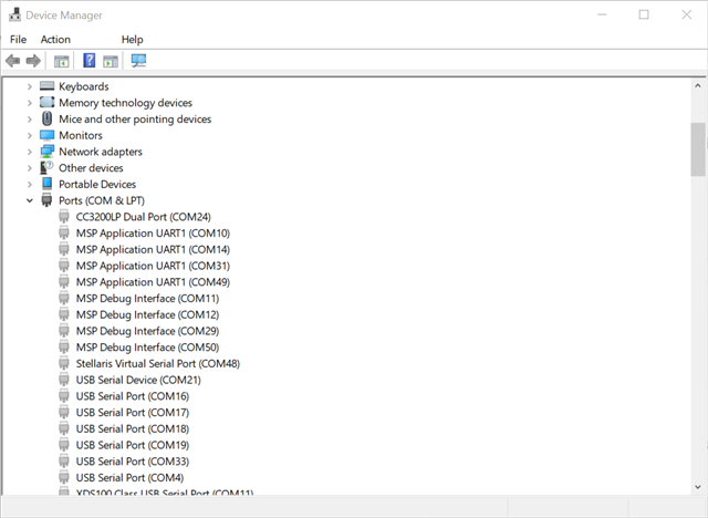

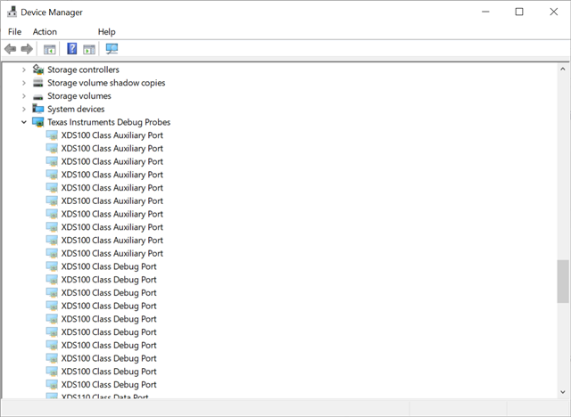

I'm trying to debug and program a CC2642 chip, and I have purchased an XDS110 debug probe. My problem lies in the debug probe and CCS 9.1.
Upon installing all of the software, my debug probe never was recognized in Windows 7. It came up as an "XDS110 Probe" but could not find drivers. I found out where the drivers were installed, and forced a driver install. However, I can only select either the "Debug" or "Data" .inf's, not both. When it installs, I get a device titled either "XDS110 Class Data Port" or "XDS110 Class Debug Port" under "Texas Instruments Debug Probes". Nothing shows up in the "Ports" category related the the device like other forum posts show.
Getting a .hex file from CCS, I can use the probe with Uniflash to flash the code to the device. However, in CCS 9.1 I cannot get it to either debug or flash, and just gives me an "Error -6311" connection problem.
Has anybody had a similar experience? I can't get both the Data and Debug ports up, is that my problem? I seem to have hit the limits of my knowledge and ability on getting this to work. Thanks for any light you can shed on this problem.
