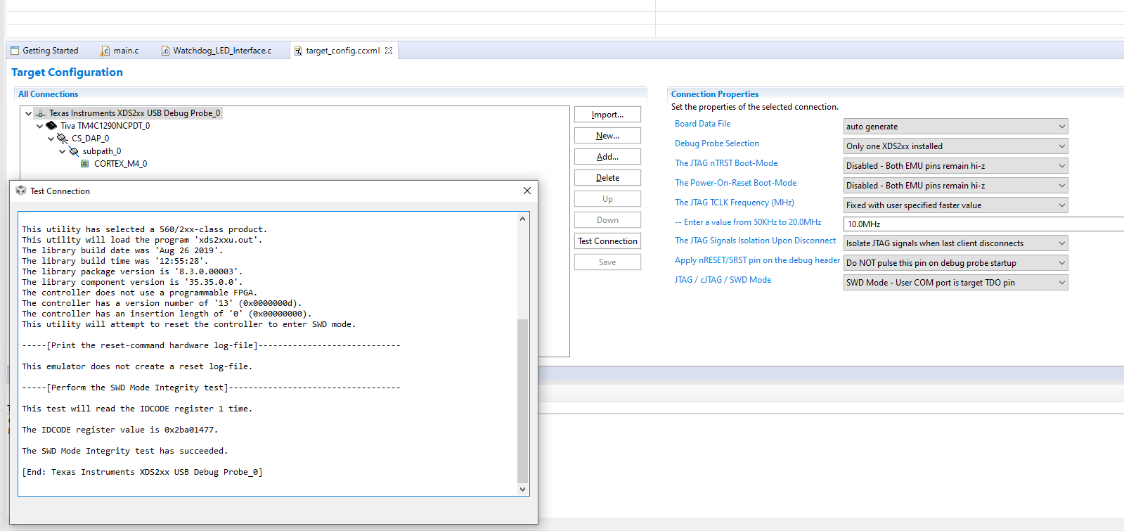

After a clean install of ccsv9, I was able to start the hardware trace analyzer successfully on one workspace
yesterday and I collected one trace. The analyzer would not start on a different project workspace yesterday.
Today, it would not start again on the workspace that worked yesterday. Can you explain what this message means?

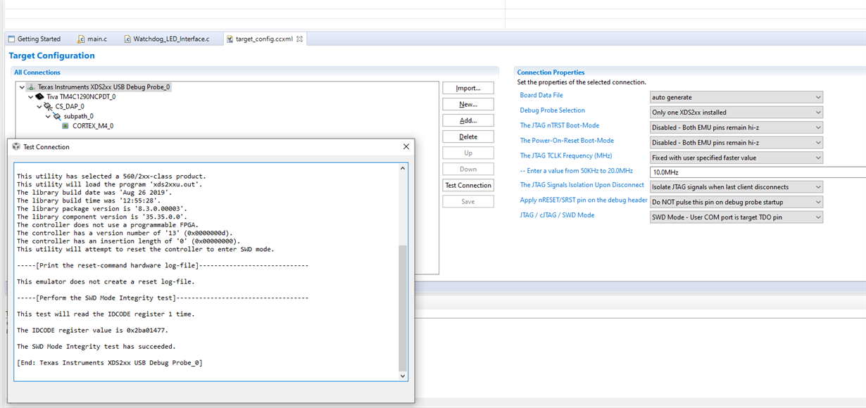

  • Priya,
    Since you are using a different project, can you be sure the target configuration file is set to SWD with SWO output?
    Rafael
  • Yes, this menu has been confirmed several times, I am set at JTAG SWD mode.
    The screenshot does show that "SWD Mode - User COM port is target TDO pin" has been selected in the target configuration.
    The 7737.file.log debug server logging attached to the first post contains the error:
    0x000009EC 106549 3  XPCOM R: ( (dsIBreakpointException*)0000015F16B0E708 )->getExplanation( *0000003A202FDBE0 = unable to select receiver:  Please check the target configuration(CCXML). Debug probe protocol must be SWD with COM port connected to TDO. ) = 0x00000000

  • Chester,
    Thank you for your response. In the screenshot above, I tried changing the COM port to XDS200 Emulator CDC Serial port (COM4). But the debugger defaults it to COM5. I continue to get the error you highlighted in the log file.

  • Priya,
    The reason of my prior remark was that projects usually have their own .ccxml file per project stored in the targetConfigs directory - thus the SWO configuration may inadvertently change (I have done this many times).
    This appears to be a tool chain issue. Not sure what I can do in the setup to change this?

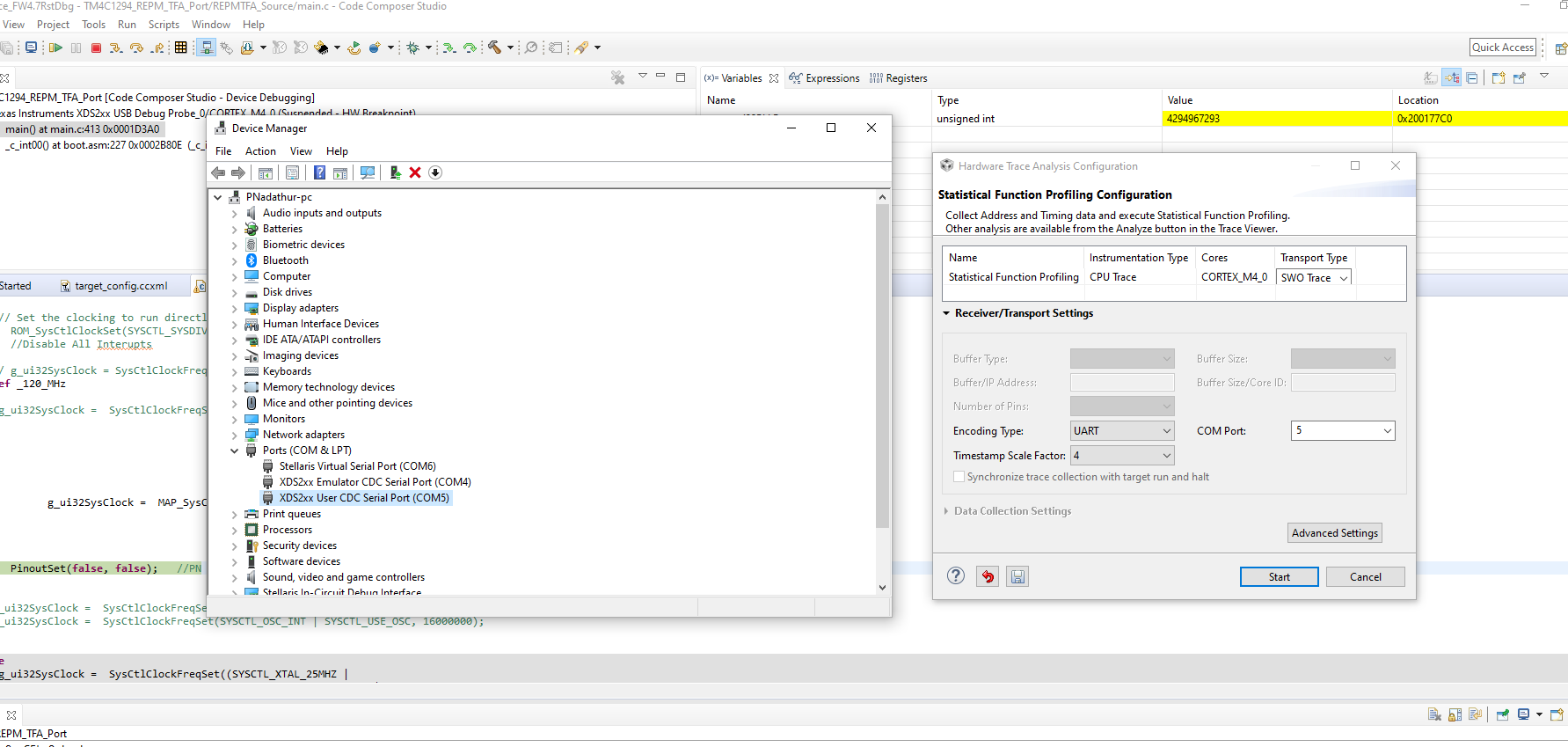

    Interesting. The COM port assigned for the SWO Trace is the one that corresponds to XDS2xx User CDC Serial Port (you can check this in your Device Manager). COM5 should be the correct value here.
    As I mentioned at the end of my post in your other thread, can you try to erase the Trace temporary files and see if it flushes this erratic behaviour?
    I am really baffled as to why you have been running into so much instability with this interface. I surely can't reproduce this here.

  • Rafael-- I often delete the entire workspace and restart CCS to make this problem go away. I went to the dvt directory and deleted the Statistical Function Profiling directory. The same error still happens. Can this have something to do with the size of the application and what the debugger is able to handle?
    I still have this in my main.c:
                g_ui32SysClock =  MAP_SysCtlClockFreqSet((SYSCTL_XTAL_25MHZ |                   //PN
                                                     SYSCTL_OSC_MAIN |
                                                     SYSCTL_USE_PLL |
                                                     SYSCTL_CFG_VCO_480), 120000000);
          PinoutSet(false, false);   //PN
    When the program halts at PinoutSet(false, false), I start the hardware trace analyzer. Is this outdated info?
    I have attached trace troubleshooting logs and the file from the dvt directory showing the trace analyzer settings.
    Thank you,
    Priya
