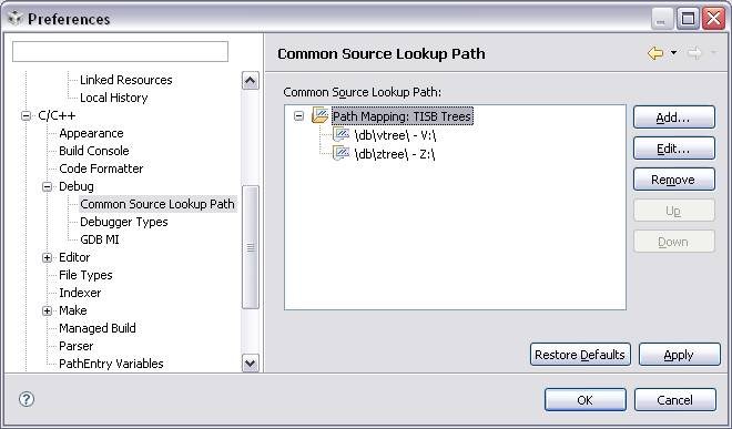

  • In XDCtools 3.20.05.76 and later, you can setup path mapping using the 'Common Source Lookup Path' dialog in Window -> Preferences in CCS, and ROV and RTA will use the information in this dialog to locate the necessary files.
    See the screenshot below (you would use this to map D:\vws to P:\)

    But now, after setup the lookup as you suggested (see below), I still get the same error below. Arg.

    Regarding the path still not working, it's important to recognize that the two paths in the error message point to different things. The first is the original path to the RTA meta data file, which resides down in the configuration package. The second is the current path to the .out file, which is in a separate place from the RTA meta data file, and usually higher up.
    So, on your CCS machine, what you're looking for is that this path is correct:
    P:/spDsp/EVM/M2_EVM6472_configuration/Default/configPkg/package/cfg/M2_EVM6472_p64P.rta.xml
    Not necessarily:
    P:\spDsp\EVM\M2_EVM6472\Debug\M2_EVM6472_p64P.rta.xml
    In your original post you said you mounted just D:\vws to P:\ ... Is it possible that your configuration package is under the folder 'ejp_M2_becInteg', but your executable is not?

  • Hmm, that's confusing, it does look like you have it setup right.
    Can you try going to Window -> Show View -> Other... -> PDE Runtime -> Plug-in Registry and verify that the version of the com.ti.rta plugin is 3.20.06.81?
    I use this path mapping feature a lot to map Linux paths to windows drives. If the plug-in version is correct, I'll have to try mapping a windows path to another windows path and see if I can reproduce your issue.
    Chris

  • Eddie - Thanks for working through this with me. I was able to reproduce your issue--it appears that this path mapping feature doesn't currently work when mapping one Windows path to another!
    I've filed the following bug:
    https://bugs.eclipse.org/bugs/show_bug.cgi?id=333047
    In the meantime, though it's a pain, you can copy the .rov.xs file from its original location and paste it in the directory containing your built executable, and ROV should be able to find it there.
