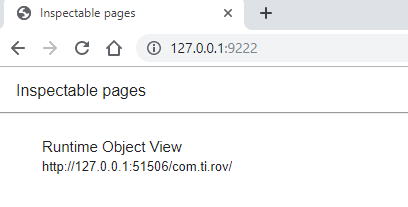

I did try to add this line from a previous post ():
-Djxbrowser-remote-debugging-port=9222
but the only output I get is this:
and if I click on it, I get an empty page:

  • > if I click on it, I get an empty page
    If you click on the "Console" tab (next to the blue underlined "Elements" tab), you should see a console log that with messages that may help us to debug the issue.

    Tobias
  • Hi Dave,
    this is the output I get in the "Console" tab after I press "cancel" after the timeout of the rov:
    2webcomponents-lite.js Failed to load resource: the server responded with a status of 404 (Not Found)
    [Deprecation] Styling master document from stylesheets defined in HTML Imports is deprecated, and is planned to be removed in M65, around March 2018. Please refer to https://goo.gl/EGXzpw for possible migration paths.
    iron-shadow-flex-layout.html:12 This file is deprecated. Please use `iron-flex-layout/iron-flex-layout-classes.html`, and one of the specific dom-modules instead
    (anonymous) @ iron-shadow-flex-layout.html:12
    iron-flex-layout.html:14 This file is deprecated. Please use `iron-flex-layout/iron-flex-layout-classes.html`, and one of the specific dom-modules instead
    (anonymous) @ iron-flex-layout.html:14
