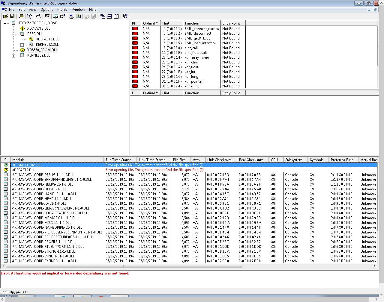

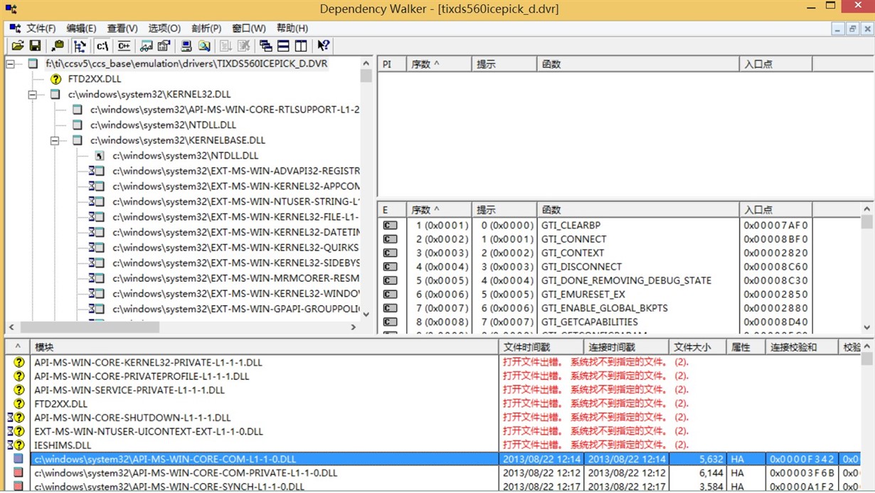

  • By using dependency walker , I found that dll files include with this (xds560icepick_d.drv)file is misiing, Do I have to re-download these dll file?
    It seems there are additional erros indeed. It is strange that you are finding several API-MS_WIN lliraries missing.
    I just did the same search on my CCSv5.5 on Windows 7/64 and found just two libraries reported missing, but they are part of the TI software anyways and may be a simple misconfiguration on my part.
    I would strongly check the reference I provided before and reinstall the MS Redistributable libraries.
