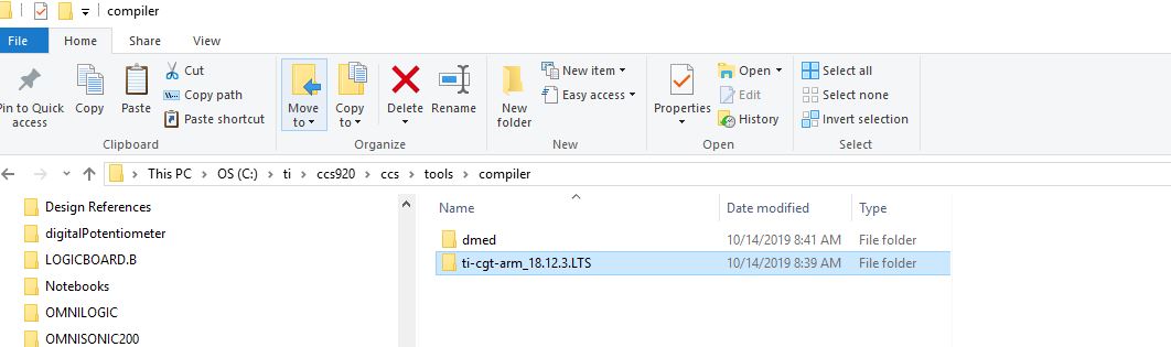

  • Attached is the list of installed software. However, the tools did not discover it.
  • I read that thread, but the site ti-cgt-arm took me to the TI code generation tools - C/C++ compilers and assembly language tools page. under arm code generation tools-compiler, I don't see the compiler version 5.2.4 . Is it included in ARM-CGT-19? thanks
  • The installer for 5.2.4 should be in your c:/ti/ccs920/ccs/eclipse/downloads directory (named ti_cgt_tms470_5.2.4_windows_installer.exe). Run that installer. When it prompts for the installation directory select the directory c:/ti/ccs920/ccs/tools/compiler/ti-cgt-arm_5.2.4, and proceed through the installation
  • I don't find the named ti_cgt_tms470_5.2.4_windows_installer.exe in the ti folder. I drilled all the way down to compiler and don't see the .exe you are talking about. is this available for download somewhere?
    It should be in the c:/ti/ccs920/ccs/eclipse/downloads directory. Is it not there?
