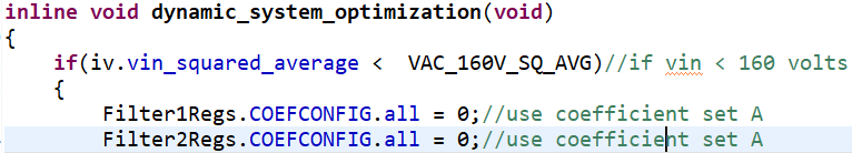

What does the 'coefficient set A' mean ?
Which coefficient does it correspond to?
Please read UCD3138 datasheet or programmer's manual. UCD can store more than one set of coefficients. Here set A is used for low line, set B is used for high line
