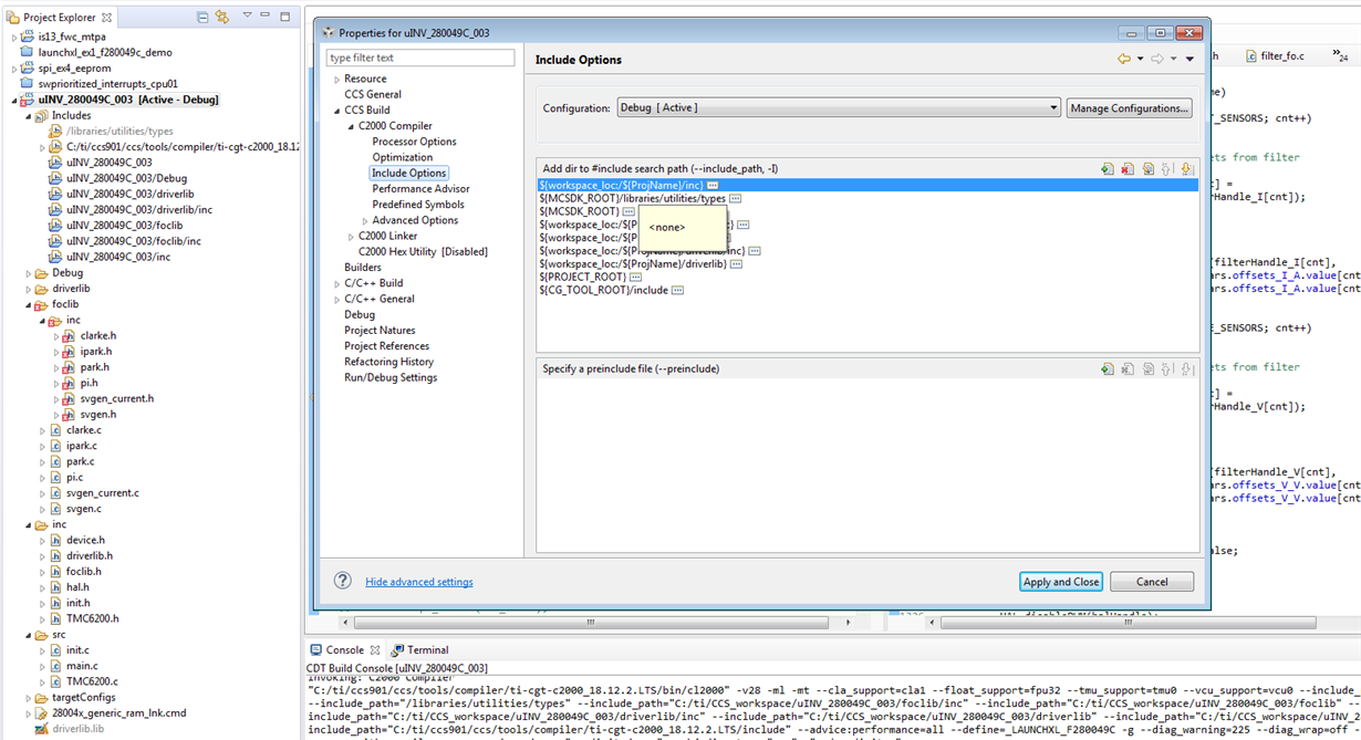

I am having troubles including header files from MotorWare library (the compiler cannot find them).
In File search path and include options I have added MCSDK_ROOT variable and some of it subfolders. (I saw it done this way in example projects.)
In Linked resources of the project, MCSDK_ROOT variable is defined as ${COM_TI_MOTOR_CONTROL_C2000WARE_SDK_SOFTWARE_PACKAGE_INCLUDE_PATH}
And going further, COM_TI_MOTOR_CONTROL_C2000WARE_SDK_SOFTWARE_PACKAGE_INCLUDE_PATH is then defined with it's definite path as: C:\ti\C2000Ware_MotorControl_SDK_2_00_00_00
(also in Linked resources of the project).
Do you have to manually add a path variable to code composer after MotorWare is installed?
When I add files from Include options using absolute path (i.e. C:\ti\etc), everything works properly.

user6047019 said:In Linked resources of the project, MCSDK_ROOT variable is defined as ${COM_TI_MOTOR_CONTROL_C2000WARE_SDK_SOFTWARE_PACKAGE_INCLUDE_PATH}
Note that MCSDK_ROOT is defined as ${COM_TI_MOTOR_CONTROL_C2000WARE_SDK_SOFTWARE_PACKAGE_INSTALL_DIR}
If you go to Project Properties->Build->Compiler->Include Options, and hover over the three dots next to the include_path ${COM_TI_MOTOR_CONTROL_C2000WARE_SDK_SOFTWARE_PACKAGE_INCLUDE_PATH}, you will notice that it says <none> next to it, which means that it does not resolve to anything. So instead of using that variable, use ${MCSDK_ROOT} instead and specify include paths relative to the root SDK directory. This is what the example projects do as well.
Hope this helps.
I have Changed MCSDK_ROOT to be: ${COM_TI_MOTOR_CONTROL_C2000WARE_SDK_SOFTWARE_PACKAGE_INSTALL_DIR},
and have added two paths that I need in Include options.
However, I still cannot get the project to include files properly.
MCSDK_ROOT resolves to <none> as can be seen from the image above.
Am I missing something else? Thanks in advance.
Tom.
EDIT: When I add a definition of path variable with name:
and location C:\ti\C2000Ware_MotorControl_SDK_1_00_00_00
when I press apply and close and then reopen the Linked recources from project options, the entry that I just added is not there.

These are the steps I had to take to resolve the include path build error.
1) First I went into the Project Properties->General->Products tab and enabled C2000 Motor Control SDK.
This sets up the COM_TI_MOTOR_CONTROL_C2000WARE_SDK_SOFTWARE_PACKAGE_INSTALL_DIR and MCSDK_ROOT variables properly.
2) Next I built the project and got a bunch of errors related to not finding "types.h"
3) types.h is in this directory within the SDK: C:\ti\C2000Ware_MotorControl_SDK_2_01_00_00\libraries\utilities\types\include
However the include path in the project's compiler options only had the path: ${MCSDK_ROOT}/libraries/utilities/types
4) I changed it to ${MCSDK_ROOT}/libraries/utilities/types/include and that made the include errors go away.
5) A couple of build errors still remain but those are coding errors and not related to the tools.
