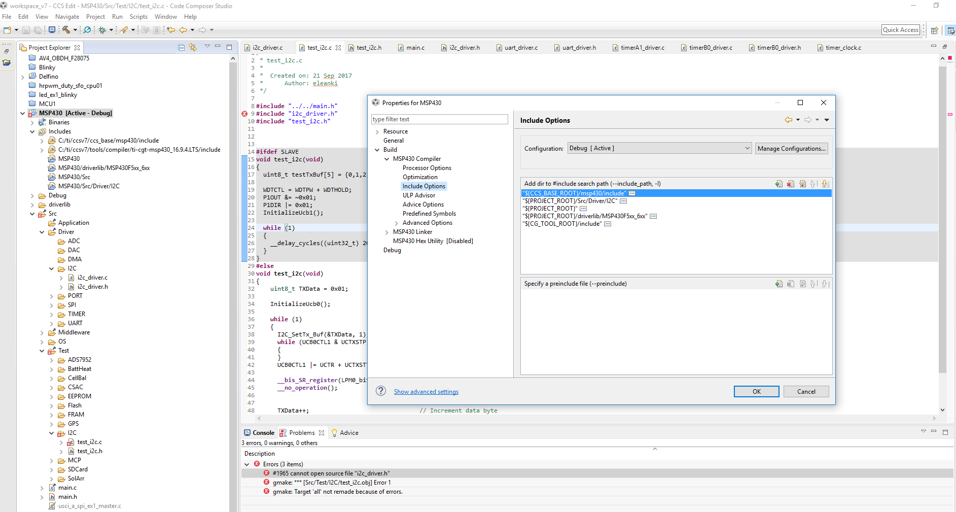

I have created Src/Driver/I2C folder in my project and created i2c_driver.c and i2c_driver.h files in that.
I have created Src/Test/I2C folder in my project and created test_i2c.c and test_i2c.h files in that.
To use the driver file i2c_driver.c, I would like to include i2c_driver.h in test_i2c.c.
One way to do that is, add #include "../../Driver/I2C/i2c_driver.h" in test_i2c.c
Another way I am trying is including the Src/Driver/I2C folder in the Include Options of the Compiler in the Project Properties and add #include "i2c_driver.h" in test_i2c.c directly. But the compiler is throwing an error saying "#1965 open source file "i2c_driver.h".
I would like to know why I am getting the error when I have already included the folder containing the driver header file.
Is there a better way to do it?
To sum up my problem, I am posting a screenshot of my project below:

    I then added the same include search path.  Note that when you put your mouse over the ... it will display the full path so that you can check if it is correct.
    Normally I use a variable more like this as that is the way it get inserted when I click the workspace button and select the folder under the project.
    But it really shouldn't matter as if I add the same variable as you it works for me.
    One thing I noticed in your screen capture is the little wrench icon on some of the folders such as Src.  This means that the folder has file specific build options set.  I am concerned that the include path is not being used when building the source file has you have overridden the build options for the files in that folder.  If the include path was added to the project after that then it would not be used when building files that are under that folder.
    There are a couple quick ways you can check that.
    1. Look at the output in the console when building test_i2c.c  I believe you will note see a --include_path that is the location of the header file.
    2. Right click on test_i2c.c in the Project Explorer and select properties.  Inspect the paths listed under Include Options.  It is likely not there.
    John
  • Hi John,
    I had enabled ccs in-built MISRA check on few of the folders, that's why there was that wrench icon. However, I cannot enable MISRA on whole project as it will start giving errors for all TI header files. Anyways I disabled the MISRA check and the problem of "not able to find header file" got fixed.
