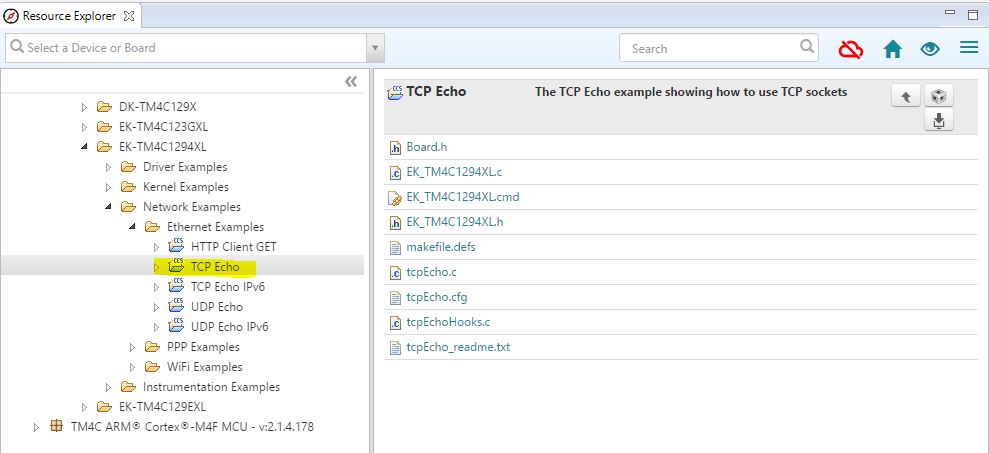

  • ok, I'm going to run the same example (the tcpEcho_EK_TM4C1294XL_TI) on my LaunchPad to see if I can reproduce it. I want to make sure two things.
      1. You can observe the hard fault with the tcpEcho_EK_TM4C1294XL_TI example as is. The example you are using is the below one.
      2. You can observe the hard fault on the launchPad board.

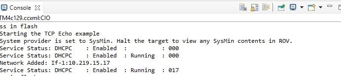

  • Hi Carlos,
       Can you please answer me if you have run the exact same example on the 'launchPad', not your custom board? I can only run the example on the launchPad. I've just run it for a couple of minutes and I don't  see any hard fault.
      I don't think the debug interface has anything to do with the problem.
      At the bottom of this post, I attached the tcpEcho example I just run. I didn't comment out any lines. I just run as is. I do not see any hard fault. Again, I run it on my launchPad. This is the reason I asked if you can see the hard fault on the launchPad. If you can see the hard fault on launchPad, then we can debug the problem. If the problem only occurs on your custom board then it will be more difficult. I don't know if there is any difference between the example you run and mine. Therefore, I suggest you try my attached example. If you can see hard fault, then please let me know how long you need to run to see it.
      I use the provided executable  tirtos_tivac_2_16_00_08\packages\examples\tools\tcpSendReceive.exe to send/receive data with the MCU. For details. refer to the tcpEcho_readme.txt file in the project directory.
    Below is the screenshot on the PC side.
    Below is the console on the MCU side. As can be seen I don't see the hard fault after running for a couple of minutes.
    Here is the example project I used.

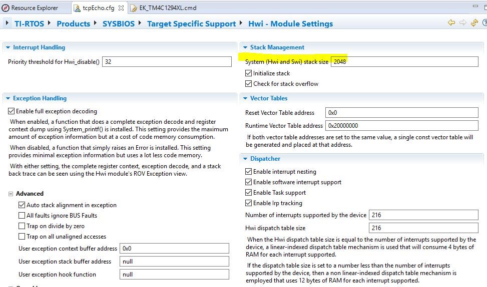

  • Hi Carlos,
      Thank you for confirming that the problem is only observed on your customer board. Honestly, I can't connect the dots yet as to why the same code will produce different results in two different boards.
      1. Can you tell me which ti-rtos version you are running? I'm using tirtos_tivac_2_16_00_08. Although your problem seems to be hardware related, I still wanted to make sure the software doesn't play any role in your problem.
      2. Can you increase the stack size? Again, most likely it won't make a difference to the result, I just wanted to try different knobs.
     3. Have you compared your board schematic with the launchPad schematic? Is there any difference?
     4. Can you try the non TI-RTOS ethernet example? The TivaWare library has some Ethernet examples such as enet_io and enet_lwip. What happen if you run these examples on your custom board? Run them on both your launchPad and custom board. Will you again see fault only on the custom board but not the launchPad?
  • Hello Charles
    I have tirtos_tivac_2_16_00_08.
    I will follow your recommendation and change the stack size to test.
    I have compared the schematics for this section in specific.  They are the same including components.
    I will also try other examples for the tiva sources.

    e2e.ti.com/.../606722
    Thank you for your support

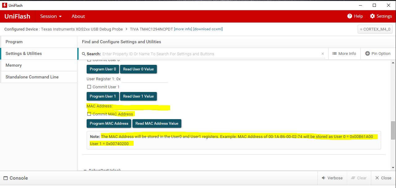

    Could you share how to program the MAC on the device? ( a long shot but worth trying
    What debug probe do you have? I believe you have the Jlink, correct? You can use the Uniflash to program the MAC address in the User0/User1 register. It will be permanently stored in the non-volatile memory.

      3. Program the MAC address to USER0/USER1 register using the Uniflash and see if it makes a difference. I know you already configured the MAC address in the EK_TM4C1294XL.c file. I also try it myself with an empty MAC address in the USER0/USER1 registers but program the MAC address in the EK_TM4C1294XL.c file and it also works for me on the launchPad. I will suggest for the time being, program the TI MAC address to your custom board. Your company's assigned MAC address should be fine. Is it possible that there are multiple same MAC address boards hooked up to your LAN. Unlikely scenarios but just wanted to make sure.

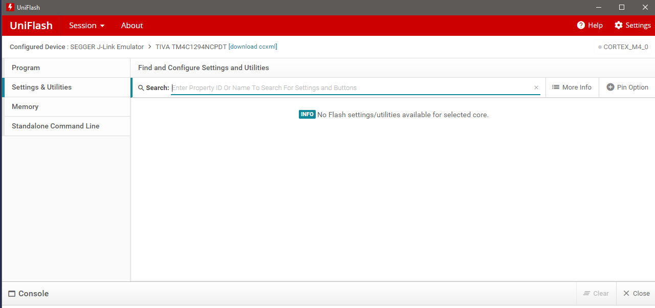

    Incidentally, I have downloaded the flash programmer to program the MAC address on urs0 and usr1 locations, could you provide detailed steps please (address process etc) thank you so much
  • Hi Carlos,
      Glad you are able to move on with your development.
      In my reply on Thu, Feb 6 2020 9:24 AM, I have shown how to program the MAC addresses using Uniflash programmer. Please refer to that post. If you have new questions such as programming the USR0/USR1 registers please open a new thread instead of continuing on this thread. Thanks.
  • Hello Charles
    Thank you for your reply.  I did see your reply and downloaded Uniflash and follow the steps however no item appears on the uniflash screen (picture attached)
  • Hi Carlos,
      I just tried it and noticed the same. I don't support the Uniflash tool. Can you please open a new thread to the CCS forum. I don't want to forward this thread to the CCS team as this thread has too many back and forth posts on not related to the Uniflash and it is too long for the CCS team to go through. So please open a new thread to the CCS forum and they will assist you.
