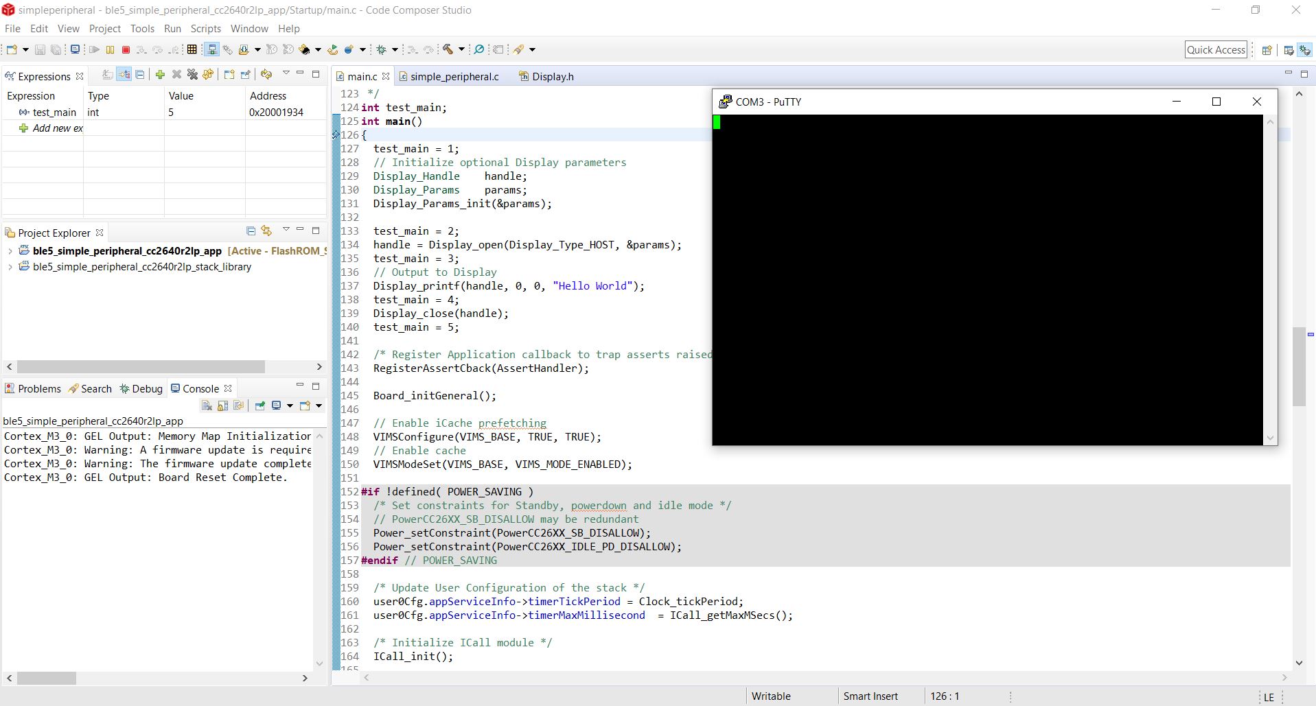

  • Hi Marie
    Thank you for your reply
    I read the display.h File and simple peripheral articles.
    Then I wrote the display code in the beginning of the main.c. I want to display a simple "Hello World" first.
    I tested puTTy, Tera Term, and the ccs serial terminal. I tested with both com ports. But nothing showed. I defined a parameter named: "test_main" to see were has the program stuck.
    So as you can see below all the codes for displaying "Hello World" has performed. But nothing has shown.
    Where is the problem?

    The Display_open() is initialized at simple_peripheral.c -> SimplePeripheral_init(). Try the Display_print0() after  Display_open().
    -kel
  • Try opening the UART instead of "Host" - this is from the display example:

  • Have you tried just using the DISPLAY_TYPE_UART?
    Have you tried the display example by itself?
  • Hi Keith, thank you for your reply.
    I tried the code you have written above. But nothing was showed.
    I haven't tried the simplelink display example yet. I gonna try it and tell you that it worked or not.
  • The M S2,
    I just tested the ble5 simple peripheral example program by default it already outputs to Tera Term. So, why are you doing all that at main.c. Delete all that code at main.c  At serial console set the correct COM port and Baud Rate. As, I have mentioned before.
    "The Display_open() is initialized at simple_peripheral.c -> SimplePeripheral_init(). Try the Display_print0() after  Display_open()."
    -kel
  • I wrote the display code in the main.c because I hadn't seen output in Tera Term and other terminals before. So I wanted to test if the display function works for me or not.
    As I said before, the module I'm working with is HM-17 and not the launchpad. Do you think it doesn't work because it is not a launchpad?
    Thank you
    Mina
  • Hi
    Yes you're right. I have to work on the hardware.
    Thank you again.
    Mina
