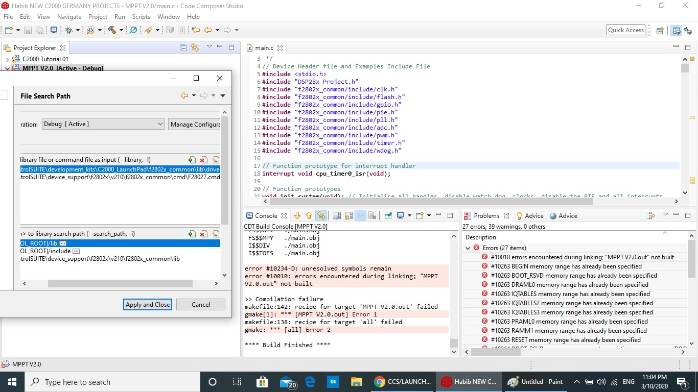

Hi
so i came across a code online and wanted to run on on my CCS, however i'm having a difficult time to get it to run due errors with include and linking paths, i would appreciate some help getting those fixed.
down below you could see the code i copied online and screen shots of the issues

error is
**** Build of configuration Debug for project MPPT V2.0 ****
"C:\\ti\\ccs930\\ccs\\utils\\bin\\gmake" -k -j 8 all -O
Building file: "../main.c"
Invoking: C2000 Compiler
"C:/ti/ccs930/ccs/tools/compiler/ti-cgt-c2000_18.12.5.LTS/bin/cl2000" -v28 -ml -mt --include_path="C:/ti/Habib NEW C2000 GERMANY PROJECTS/MPPT V2.0" --include_path="C:/ti/controlSUITE/development_kits/C2000_LaunchPad/f2802x_common/include" --include_path="C:/ti/controlSUITE/development_kits/C2000_LaunchPad/f2802x_headers/include" --include_path="C:/ti/ccs930/ccs/tools/compiler/ti-cgt-c2000_18.12.5.LTS/include" --include_path="C:/ti/controlSUITE/device_support/f2802x/v210/DSP28x_Project.h" --include_path="C:/ti/controlSUITE/device_support/f2802x/v210/F2802x_Device.h" --preinclude="C:/ti/Habib NEW C2000 GERMANY PROJECTS/MPPT V2.0" --preinclude="C:/ti/ccs930/ccs/tools/compiler/ti-cgt-c2000_18.12.5.LTS/include" --preinclude="C:/ti/controlSUITE/device_support/f2802x/v210/DSP28x_Project.h" --preinclude="C:/ti/controlSUITE/device_support/f2802x/v210/F2802x_Device.h" --preinclude="C:/ti/controlSUITE/development_kits/C2000_LaunchPad/DSP28x_Project.h" --preinclude="C:/ti/controlSUITE/development_kits/C2000_LaunchPad/F2802x_Device.h" --preinclude="C:/ti/controlSUITE/development_kits/C2000_LaunchPad" --advice:performance=all -g --diag_warning=225 --diag_wrap=off --display_error_number --abi=coffabi --preproc_with_compile --preproc_dependency="main.d_raw" "../main.c"
>> Compilation failure
subdir_rules.mk:9: recipe for target 'main.obj' failed
Command-line error #1966: cannot open source file "C:/ti/Habib NEW C2000 GERMANY PROJECTS/MPPT V2.0": Invalid argument
1 catastrophic error detected in the compilation of "../main.c".
Compilation terminated.
gmake: *** [main.obj] Error 1
gmake: Target 'all' not remade because of errors.
**** Build Finished ****
Hello Ahmed,
You have directories in your list of --preinclude files. This option is expecting files. This is the source of your error. Note that --preincludes is different from header file include search paths (--include_path). A common mistake is to add header file include search paths to the --preincludes file list. Please check this.
ki
Ahmed Habib said:i have removed the heder and folder files from the preinclude =, however that still does not solve the issue, actually i got more errors by removing them
Actually, that did remove your first set of errors. Now it exposed the other ones. Your issue now is that you are missing some include search paths.
Specifically:
C:\ti\controlSUITE\device_support\f2802x\v210
You also reference header files directly in your include search path. You are only supposed to put search paths there.
You are likely missing other include search paths.
Please carefully make sure you have all the required paths needed for your project.
Also take a look at the C2000 compiler user's guide for more information..
http://dev.ti.com/tirex/explore/node?node=APrU60ITeJcy-f1L4BfYJA__FUz-xrs__LATEST
ki

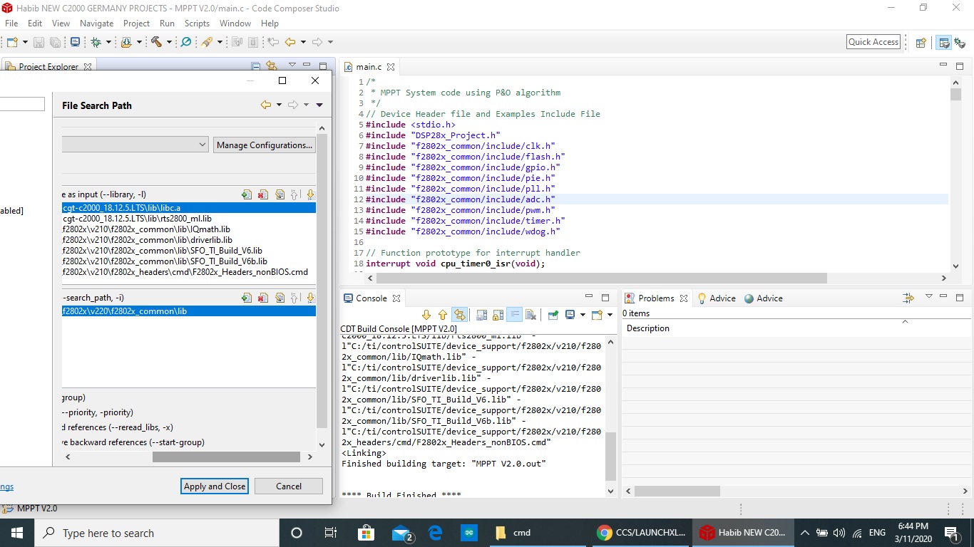

Yes, they are all linker errors. There are two main errors. The first is a common one:
https://software-dl.ti.com/ccs/esd/documents/sdto_ccs_build-errors.html#error-10234-d-unresolved-symbols-remain
https://processors.wiki.ti.com/index.php/Compiler/diagnostic_messages/10234
Basically you need to make sure you are including the library/source that defines the missing symbols
The second is likely because you have two linker command files in your project that are conflicting with each other.
ki
