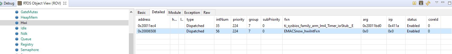

I'm trying to manually configure my application using C code and Cfg*() functions (as described in spru523k, section 2.1), but when I ran my code, the console showed the message:
ti.sysbios.family.arm.m3.Hwi: line 143: E_alreadyDefined: Hwi already defined: intr# 56
00000.000 ExecStart: Already Open
00000.000 mmFree: Double Free
00000.000
NC_NetStart: WARNING: Boot thread has not completed!
00000.000 NodeTreeFree: Null endpoints
and the function NC_NetStart() returned -1. Can anyone help me to solve this?
I'm attaching a print of the ROV -> Hwi screen and my code:

  • Hi Ronan,
    When you use the .cfg to configure the NDK, it generates the Network Stack Task. Since you are providing it also, you are getting duplicates. I would simply remove the NDK related code from the .cfg. You'll need to add in the the NDK library also (since the .cfg does that for you also).
    Todd
