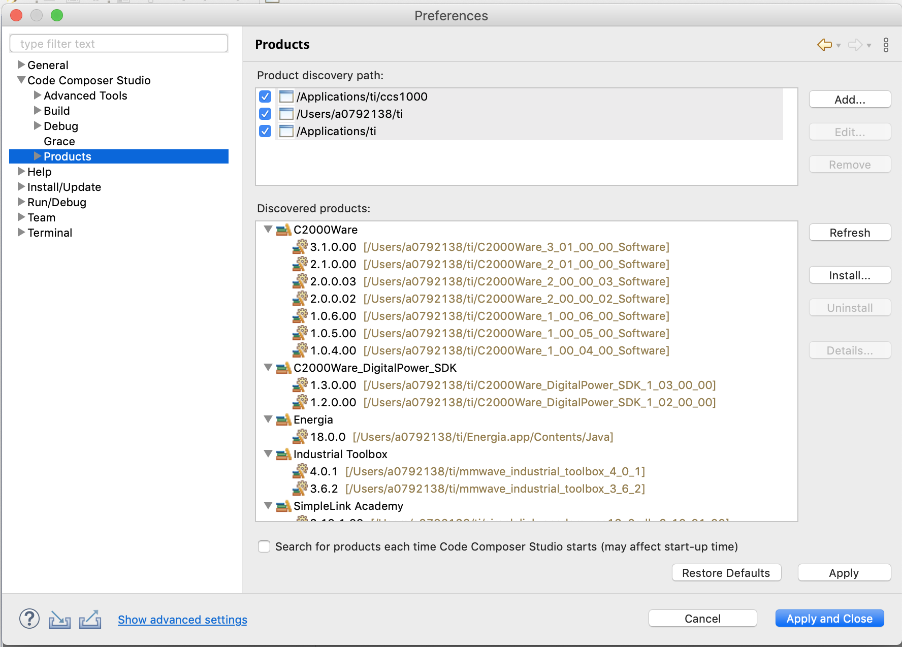

  • Resource Explorer should automatically discover Tivaware if it is installed in the default location.
    You can specify where CCS (and Resource Explorer) will look for packages in the preferences dialog here:
    In your case it really seems like where Tivaware is and where Resource Explorer thinks it is are different.  Did you install TivaWare from Resource Explorer or by manually downloading and installing?  If the later what I would suggest as a quick fix would be to click on the 3 vertical dots in resource explorer beside the package and select to uninstall.  When that is done click on them again and select to install.  That hopefully gets things back in sync.
