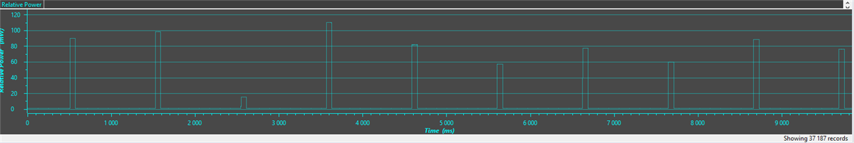

Reference measurements are taken with a scope and a 10-ohm resistor on the low-side (GND). I got these results :

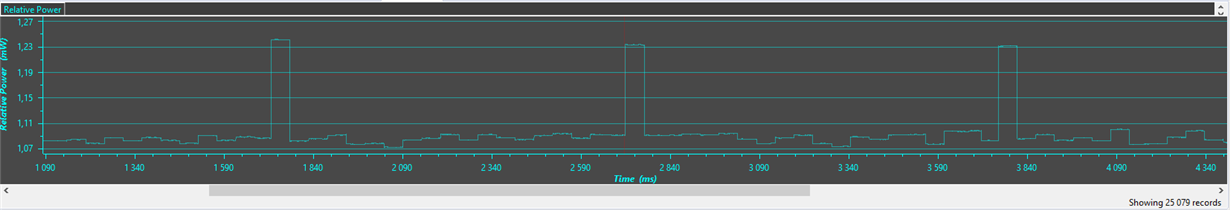

Below is a current measurement of the system on multi-seconds scale.
Below isa current measurement of the system of a single burst zoomed
All looks correct regarding the system specs and what it acutally does.

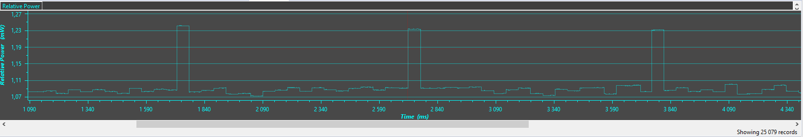

On the other hand, when removing the scope and resistor and measuring the current with EnergyTrace, I got the following results.
Below is the current measurement of the system on a multi-second scale
Below is a zoom on a single burst
EnergyTrace actually thinks that the current bursts lasts around 1s !
And the average current given by EnergyTrace is around 8mA where the correct measurement is around 170µA

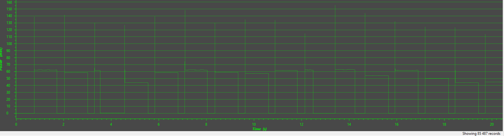

  • Hi Johnson,
    I've rebuilt a easier setup for that (complete code was waiting for the radio answer packet and stuff).
    Loop is :
    - Radio TX (continious wave) for 1ms
    - Sleep for 1000ms
    I've made 3 measurements :
    - system with Radio
    - system without Radio (replaced by a LED)
    - system with without radio nor LED
    Below are the screens of EnergyTrace :
    #1 : System with radio
    #2 : System with LED
    #3 : System with nothing

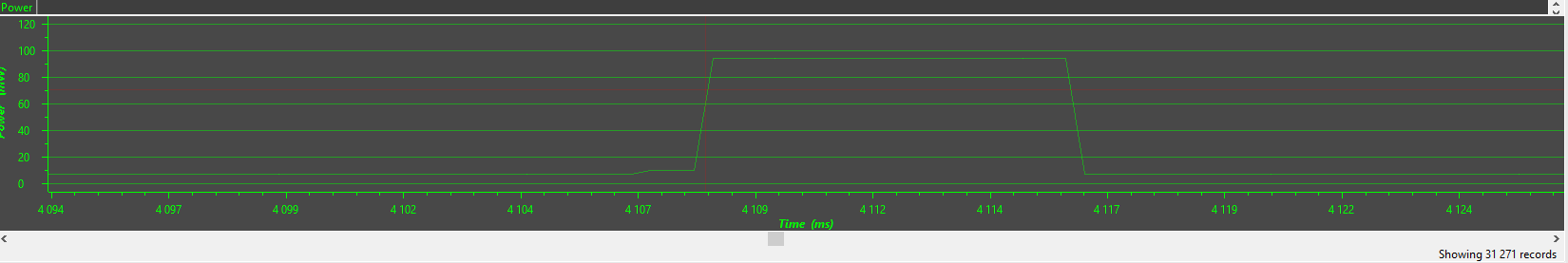

    To analyse these screens:
    #3 shows the LPM0 current => good
    #2 shows spikes of the LED => already off as the spike lasts for ~50ms in the trace. I validated the voltage of the LED with the scope and it only lasts 1ms
    #1 shows spike of TX continious waves => also way off. Interestingly, the values of the peak are not even the same and looks random

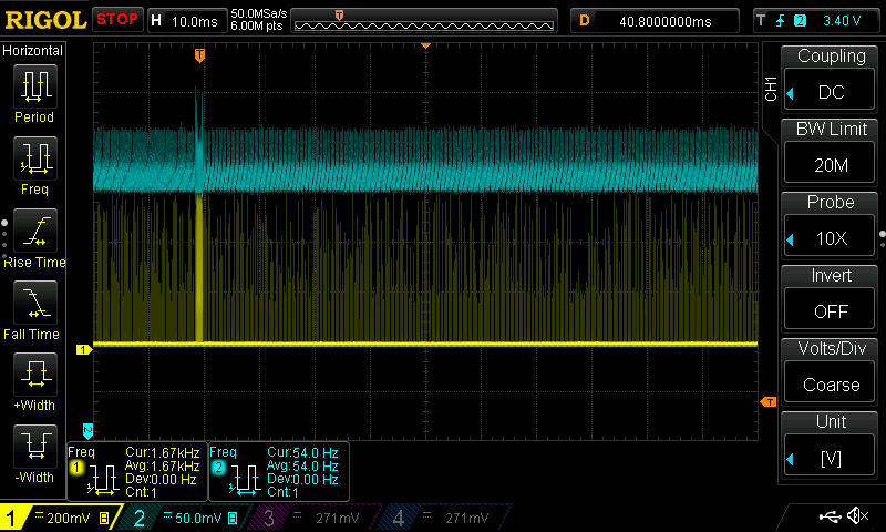

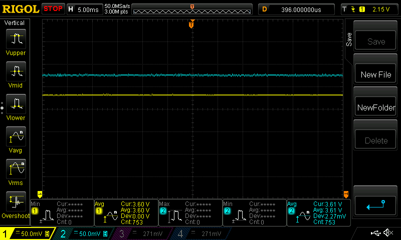

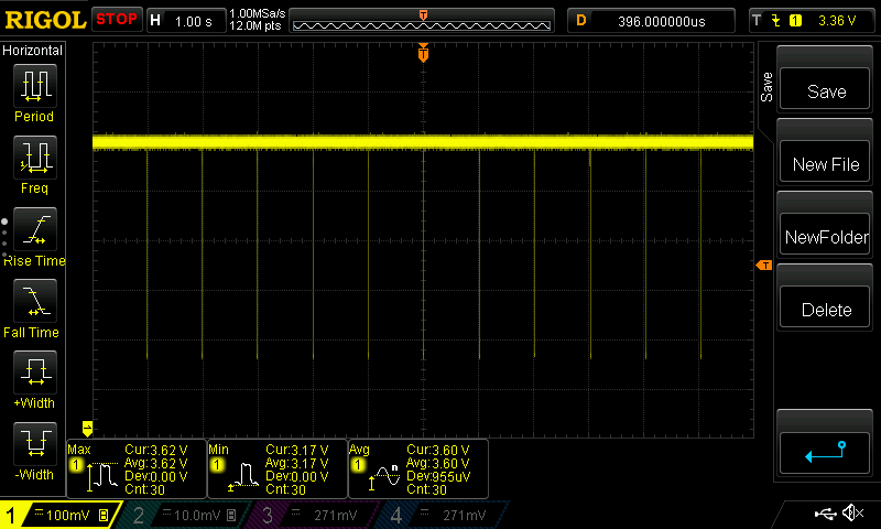

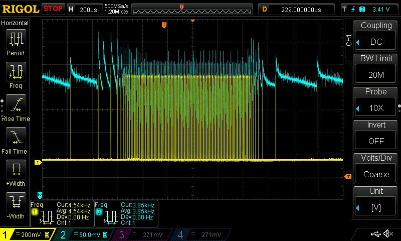

  • Hi Johnson,
    You're right, I forgot about the scope measurement. I just took them.
    To measure current with the scope, I added a 10-ohm resistor on the high-side (between the 3.6V regulated voltage and the system VCC. I then measured the voltage and looks for the "drops" in VCC.
    Below are screens of the scope for with and without RF module
    Drops of TX continious wave every second. Drops value is repeatable and stable
    Zoom on a single drop. It lasts for about 1ms. Drop value is 460mV => 46mA (close to expected)
    No Radio. Voltage is very stable but interesting value (LPM0 current) is under the radar here.
    RF module for test is CC1101. Simple setup code is attachedCC1101_Test.zip
    Romain

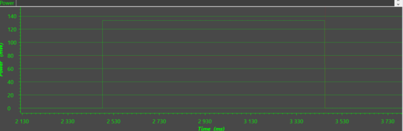

  • I've looked into the EnergyTrace schematic (for example p.41 of slau535b) and the 13/329073 patent.
    So EnergyTrace is (quite smart by the way) sending finite-energy pulse to the buck. My guess about actually measuring is counting the number of pulses sent over a period.
    So I've tapped and looked on the scope what actually happenned on the Buck side (EZFET_DCDCPULSE and EZFET_VCCOUT) on the scope to see if something weird happens here that could actually explains the issue.
    Below are scope catpures
    Single TX burst (CH1 : EZFET_DCDCPULSE, CH2 : EZFET_VCCOUT).
    Here we see clearly the increase in drops and regulation pulses (so increased power consumption)
    Zoomed-out TX burst with 100ms after. Surprisingly, I don't see anything on EZFET_DCDCPULSE frequency changing during the next 100ms. However, EnergyTrace software see a constant high-power level that lasts 50ms.
    My conclusion is that the issue must be software related (either in the MSP430G2452RSA chip used to control the Energy-Trace buck or in CodeComposerStudio itself)
