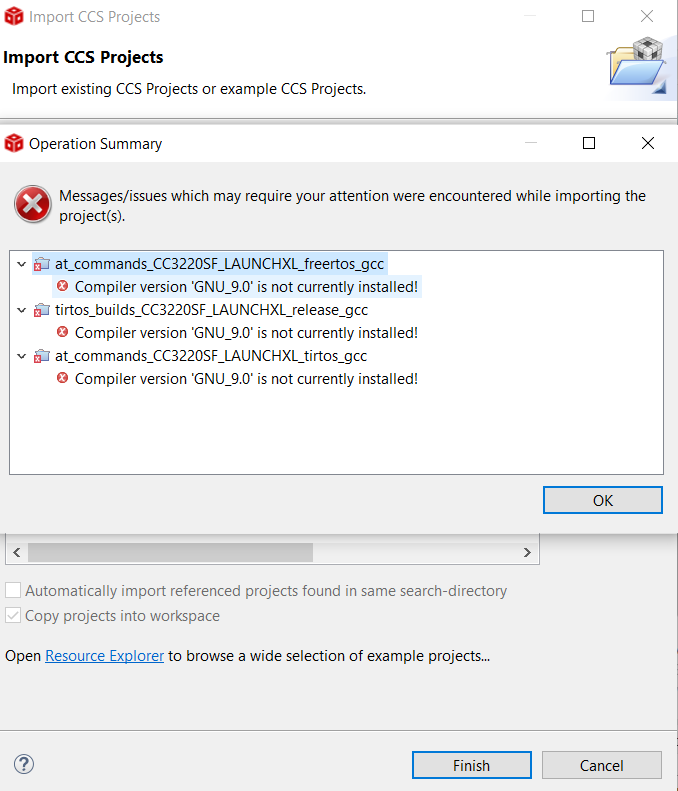

When importing any project at the final step when you click on finish it gives me an error GNU 9.0 compiler is not installed. Was trying to import an RTOS project from demo in simplelink_cc32xx_sdk.. and happens for other projects too. CCS version 10 and updated. On a side note the project does show up in the file explorer and all files seems to be present. The project is able to build too. Would like to know a fix and if this could cause a problem down the line.

  • That did not solve me problem. Attached is a screenshot of the exact problem. Followed the steps mentioned above.

  • Looks like CCS is not detecting the GCC install automatically like it should.
    You can fix this by going to the preferences dialog from the Window menu.
    Navigate to here.
    Add the location of the GCC9 install.  It will be <your ccs install dir>/ccs/tools/compiler/gcc-arm-none-eabi-9-2019-q4-major
    Once I do that I can import fine.  I will look into why CCS did not detect GCC automatically like it usually does.

  • Chester,
    I think it is the same issue.  My adding a path triggered a refresh but I bet if I manually clicked refresh that would have worked too.  I just tried the same with a TI ARM compiler update and I had to manually click refresh.
