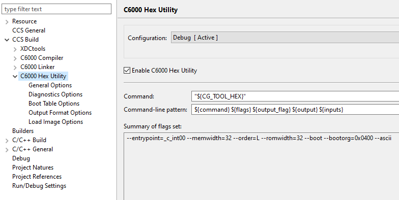

Is there any way to convert the intel hex file to a binary file or directly generating a binary file from code composer v9 as its not from the option , to burn the .bin file using boot loader and LM flash programmer?
    There should be a thread on the forum about hex utility usage. It can be used as post-build event to generate binary out of your hex.

  • Hi again,
    For ARM flow we better wait till guru jump in.
    As for me, for C6000 I have hex utility option right in the build settings, so technically it is not general post-build step. Just take a look on screenshot
    The command looks ok, but can you see if the Console output shows a specific error?

    I am not sure if it was an artifact of the copy/paste on your post, but the command line does not have any spaces between the different parameters. It should be something like this:
    Console said:
    "${CCS_INSTALL_ROOT}/utils/tiobj2bin/tiobj2bin" "${BuildArtifactFileName}" "${BuildArtifactFileBaseName}.bin" "${CG_TOOL_ROOT}/bin/armofd" "${CG_TOOL_ROOT}/bin/armhex" "${CCS_INSTALL_ROOT}/utils/tiobj2bin/mkhex4bin"
    Rafael
  • It worked!. The command seems to have spaces thanks for your reply
