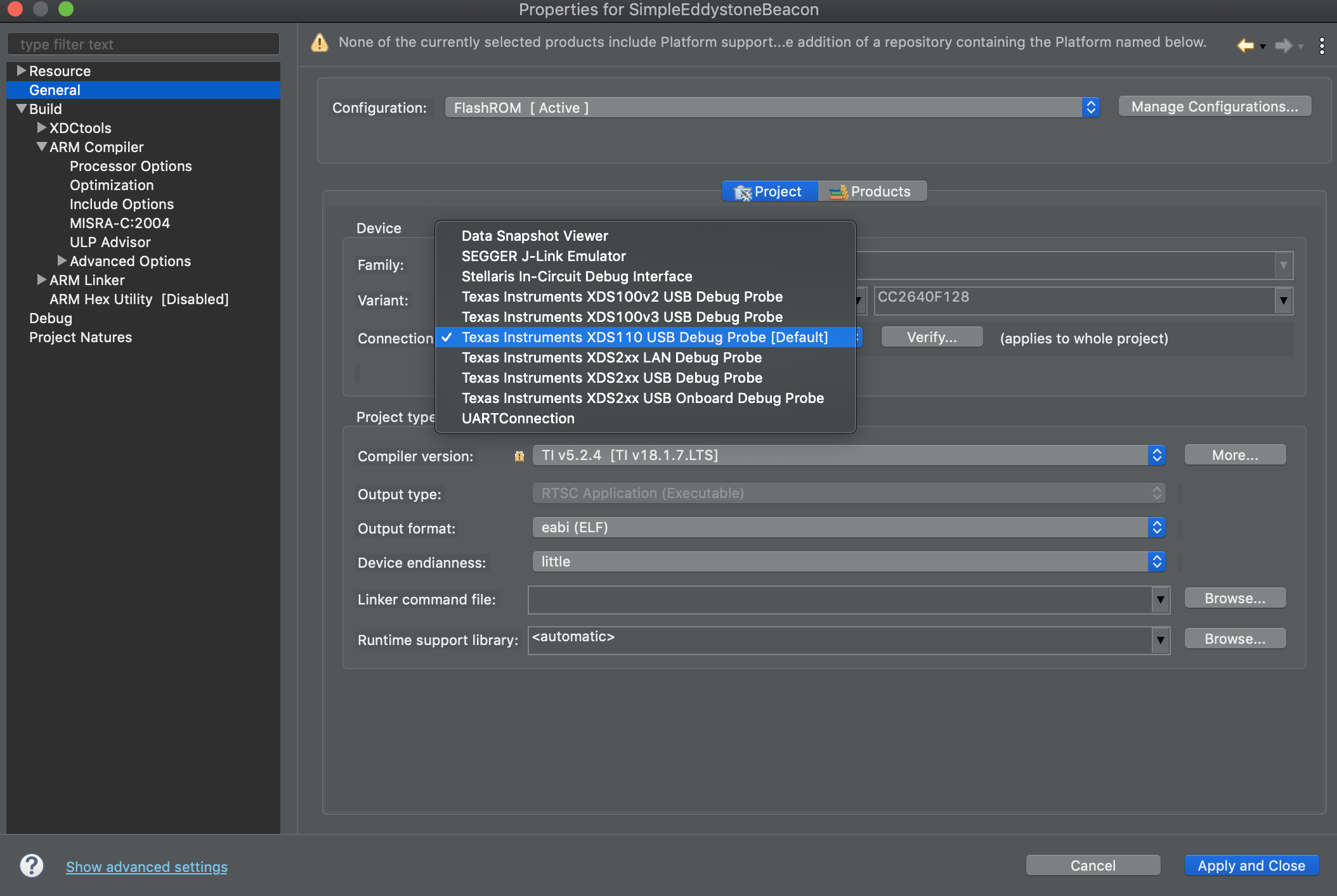

    Are you trying to debug the IWR1642 via the XDS110 JTAG debugger that is on the board?  The error message sounds like the configuration in CCS is set for the UARTConnection type.
    I am on mac so I don't have the mmWave software installed.  The connection would either be set in the project properties here:
    Or there would be a .ccxml file in the project.  If you double click on the file it will open the editor and you can change the connection here:
