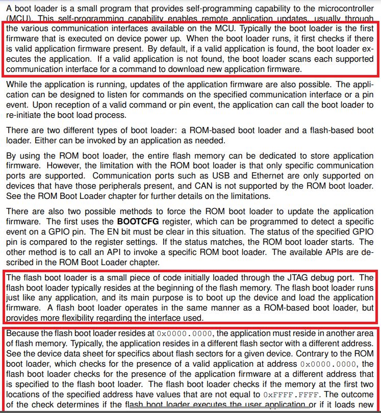

      You cannot just start your application at 0x4000 unless you have a bootloader starting at 0x0. The processor after reset expects a valid stack pointer and reset vector at 0x0 and 0x4. If you don't have a bootloader than it means there is nothing between 0x0 and 0x4000. You binary will not work. You either need to have your application starts at 0x0 or you have a bootloader starts at 0x0 that will jump to your application at 0x4000.

      I will suggest you try the serial bootloader example and have a feel how it works. You can find the serial bootloader in <TivaWare_Installation>/examples/boards/ek-tm4c1294xl/boot_serial. The bootloader will program the application firmware (boot_demo1) at address starting 0x4000. The boot_demo1 application is a simple blinky program but with additional capability to listen for command to jump back to the bootloader.
      In the bootlaoder project you will find the file bl_config.h and you can specify where the application address will be. See below.
    // The starting address of the application. This must be a multiple of 1024
    // bytes (making it aligned to a page boundary). A vector table is expected at
    // this location, and the perceived validity of the vector table (stack located
    // in SRAM, reset vector located in flash) is used as an indication of the
    // validity of the application image.
    // The flash image of the boot loader must not be larger than this value.
    // Depends on: None
    // Exclusive of: None
    // Requires: None
    #define APP_START_ADDRESS 0x4000

      You keep using blink.bin and I have told you multiple times to use boot_demo_emac_flash. When you said blinky.bin do you really mean the simple blinky program in TivaWare or the boot_demo_emac_flash?
      If the download is successful you should be able to see the application image at 0x4000 using the CCS memory browser. Once the application is loaded, if you want to debug, you simply load the symbol instead of loading the program. In CCS, you go to Run->Load->Load symbols and provide the boot_demo_emac_flash.out as your symbol. If you use LM flash programmer (acting as the tftp server and bootp server) to download the code it will also tell you if the download was successful. Tell me if you use the LM flash programmer at all?
    Sergey uskach said:
    My use case is program boot-loader at 0x4000  load symbols into debugger and setup break point and examine variables.
    The bootloader must start at 0x0 and your application will start at 0x4000? Why are you doing this differently? After reset, the CPU starts at 0x0. The bootloader will first check if there is application image present at 0x4000. If there is a stack pointer and reset vector present at 0x4000 and 0x4004 then it just jumps to the application. If the application is not present, it will boot load from the Ethernet interface. You can use the LM flash programmer to download your code. The bootloader cannot start at 0x4000 and the application at 0x0. You got it all wrong if that is what you try to do. What happens if there is no application yet and how will the processor start at 0x4000? What happens if your application is large like 512kB and how can you have the application start at 0x0 and the bootloader at 0x4000?
    I really suggest you read the bootloader user's guide to be familiar with what bootlaoder is and how it works. Here is the link.

      In my last reply I gave you the link to the Booloader user's guide. If you read it, then introduction section says the bootloader will reside at 0x0. See below excerpt. You can refer to the user's guide link I provided again.
      About downloading debug symbols, I also provided my answer in my last reply. Did you miss it? I said once you successfully download your application (boot_demo_emac_flash) from the Ethernet interface, you can load the corresponding symbols using the boot_demo_emac_flash.out file. Please go back to answer on Tue, May 19 2020 4:12 PM. I'm quoting what I said again.
     "If the download is successful you should be able to see the application image at 0x4000 using the CCS memory browser. Once the application is loaded, if you want to debug, you simply load the symbol instead of loading the program. In CCS, you go to Run->Load->Load symbols and provide the boot_demo_emac_flash.out as your symbol. If you use LM flash programmer (acting as the tftp server and bootp server) to download the code it will also tell you if the download was successful. Tell me if you use the LM flash programmer at all?"
    I still don't understand why you want to erase 0x0-0x3FF. I have said multiple times that bootloader starts at 0x0. Please explain why you want to erase the bootloader and why you don't want the bootloader starting 0x0 but rather at 0x4000.

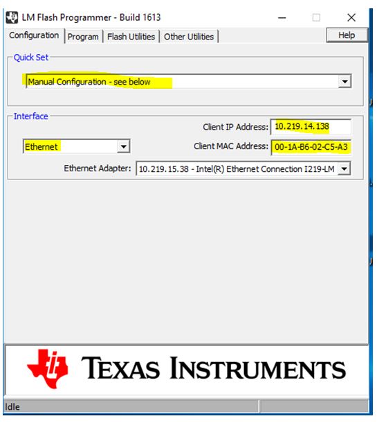

      I believe I have been patient and I thought I have given your all the steps to run the bootloader. If you want step 1, 2, 3 then here they are. If they are still not clear then I really don't know what and how to help you.
     Step1: Run the enet_lwip or enet_io to obtain the IP address. The reason I didn't say this step in my prior replies is because you said you modify the code for a static IP already. I will explain why you need this IP address. I want you this time to NOT modify any examples at all. Just follow the steps I show here. So the first thing is to run either the enet_lwip or enet_io. On the terminal window you should see the IP address printed out. Record this address.
     Step2: Load the boot_emac_flash via the JTAG interface using CCS. This is the bootloader to be loaded at 0x0. DO NOT change to 0x4000.
     Step 3. Bring up the LM flash programmer. See below image. Provide the IP address that you just record in step 1 and enter the IP address and also the MAC address. If you are using the LaunchPad, the MAC address is shown on the sticker on the back of the board.
    Your PC will be your TFTP server as well as a BootP server to transfer the program image to the MCU (the client). You need to inform the BootP server for the MCU’s IP address and its MAC address. This is how a BootP server works. Unlike a DHCP server, the MAC address and its associated IP address must be manually entered and known ahead of time because BootP is static in nature. This is why we enter them in the configuration tab. However, we don’t know what IP address to enter. We cannot enter any arbitrary address that might interfere with other IP address in the network.
    This is the reason we must first run a different Ethernet example such as enet_lwip. The enet_lwip will send the DHCP request. After the IP address is acquired we will just record the IP address value for reuse in boot_emac_flash. The IP address acquired by running enet_lwip shows 10.219.14.138 in my image. Note your address will be different from mine. The reason we can use this address is that the DHCP IP address is leased for some hours. The address we acquired by running the enet_lwip will be good for a few hours.

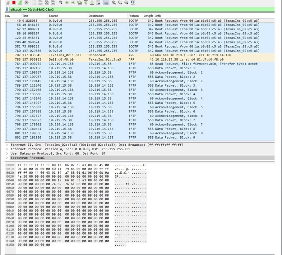

     Step 7. Suppose everything went smoothly and the boot_demo_emac_flash application was programmed and if you want to debug it, you can load the symbol by going to Run->Load->Load Symbols. The symbol is contained in the boot_demo_emac_flash.out. Note it is the .out file. Do load symbols, not to be confused with Load program.
    I will suggest you use WireShark to view the traffic between the MCU and the TFTP/BOOTP server. Below is what you should see. The MCU will send BOOTP request to the PC and after the handshake the TFTP sever sends the program image (boot_demo_emac_flash.bin) to the MCU via the Ethernet interface.
