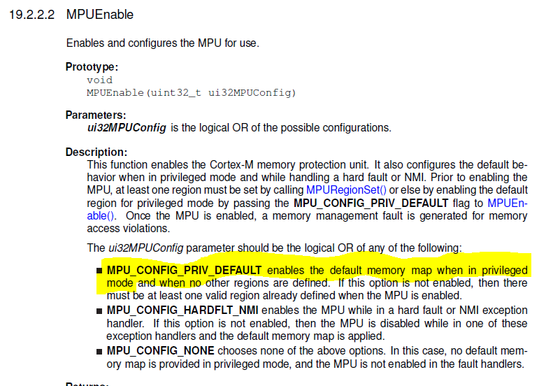

  • Did you leave privileged mode? Your call to MPU_Enable() puts back the default map in privileged mode. Also, you should not set this region as MPU_RGN_PERM_EXEC. You should never try to execute code from this location.

  • I suspect you are still in privileged mode as that is the default. You need to change to unprivileged mode by writing to the CPU CONTROL register or use "MPU_CONFIG_NONE" instead of "MPU_CONFIG_PRIV_DEFAULT"

  • As I posted before, the line
        MPU_Enable(MPU_CONFIG_PRIV_DEFAULT);
    in your code causes the default memory map (not the MPU) to be used in privileged mode.

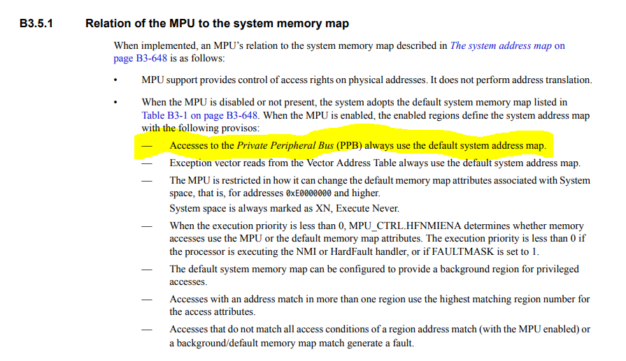

  • Sorry, this took me a while to figure out. First, what I said about using MPU_CONFIG_NONE does not help because that disables the default map which means the flash code was now in unmapped space. That is why it immediately gave a Fault NMI.
    According to the ARM V7 Architecture Reference Manual, access to the private peripheral bus always use the default map.
    From the CPU block diagram in the datasheet we see that the MPU registers are on the private peripheral bus:
    This means that you cannot use the MPU to protect these registers.  Since these registers are only writeable in privileged mode, the easiest way to protect them is to go to non-privileged mode:
        // Change to non-privileged mode
        asm(" mov r0, #1");
        asm(" msr control, r0");
