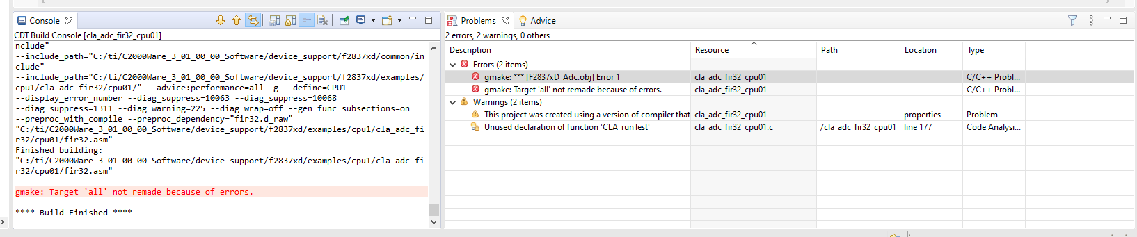

I'm working with the "TMS320F28377D" and, because a reasons, i had to format my PC, so, i reinstall CCS10 and C2000ware, and now, i can´t run the examples, i don't know why.
i'm getting this errors:
gmake: *** [F2837xD_Adc.obj] Error 1
gmake: Target 'all' not remade because of errors.
I need to keep working on this, so, any help is welcome.

Hi Siddharth:
Q: What is the compiler version that you are using?
A: I'm using the latest version of CCS10 (TI v20.2.1.LTS)
Q: Are you facing this issue with all examples?
A: Not with all, but it's happen with the most.
Q: Can you try switching to a new CCS workspace and see if you get the same error?
A: yes i tried but it didn't work.
i don't really know what happen, the program worked before formatting the computer :(
i'm still getting the same problem: "Field XXX could not be resolved"
Were you able to resolve this issue? Can you try to recompile the examples after installing compiler version 18.2.4.LTS from the below link?
