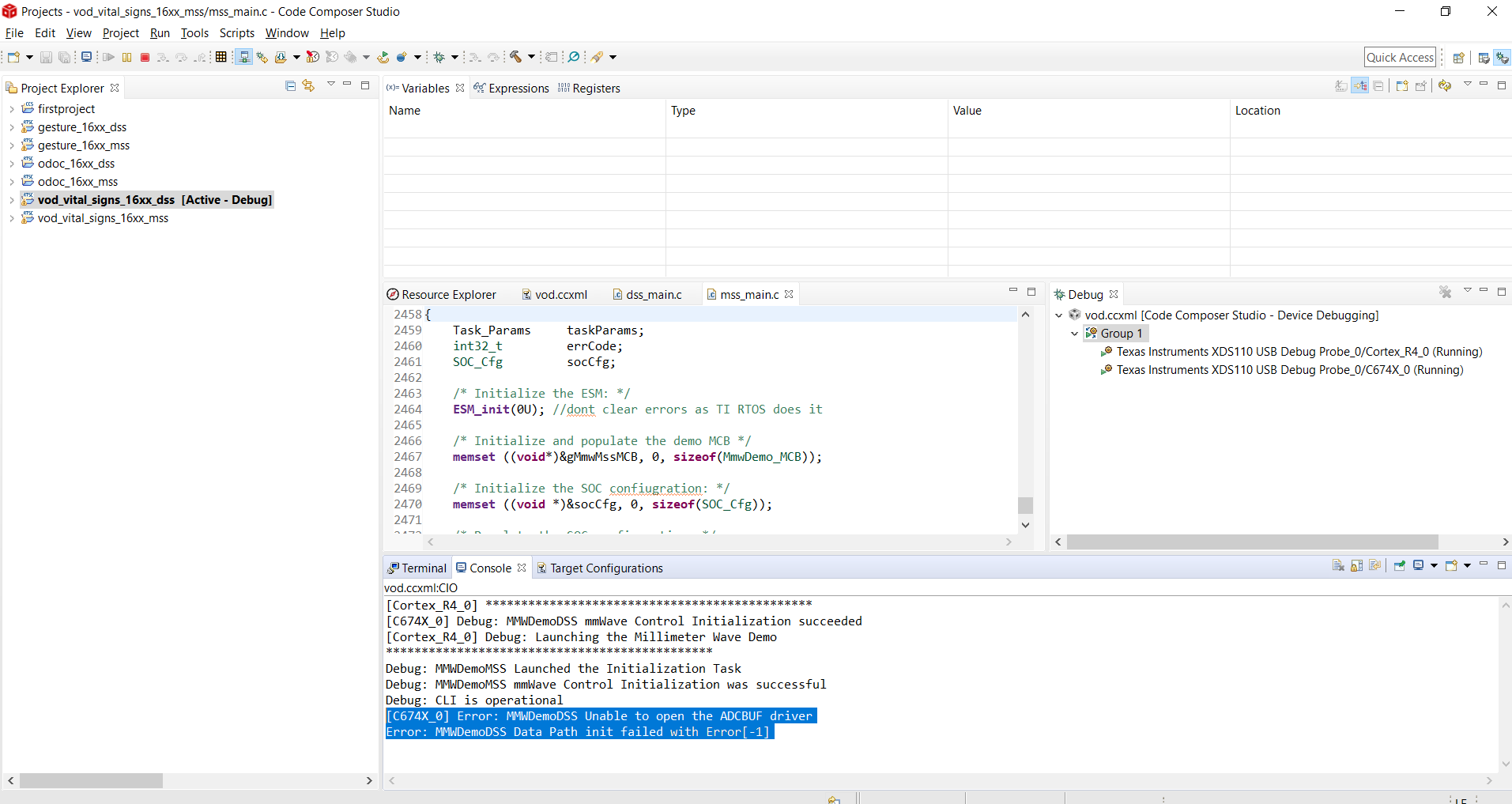

I am currently working on a demo, I have this problem, what I have photo uploaded, I want to know why I get this error and how I can fix this error.

Have you modified the profile configuration that is sent to CLI? If not, are you able to run other demos with the same SDK?
-dave
Hi dave,
yes i have changed that, yes i able to run anoder Demos. Maybe i should change the code, i found this problem in e2e Forum.
dss_main.c ----->
ADCBufparams.continousMode = 0;
ADCBufparams.socHandle = gGestDssMCB.socHandle;
/* Open ADCBUF driver */
context->adcbufHandle = ADCBuf_open(0, &ADCBufparams);
What do you think about that?
