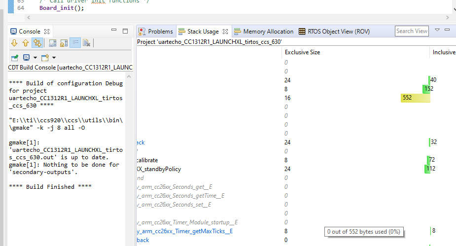

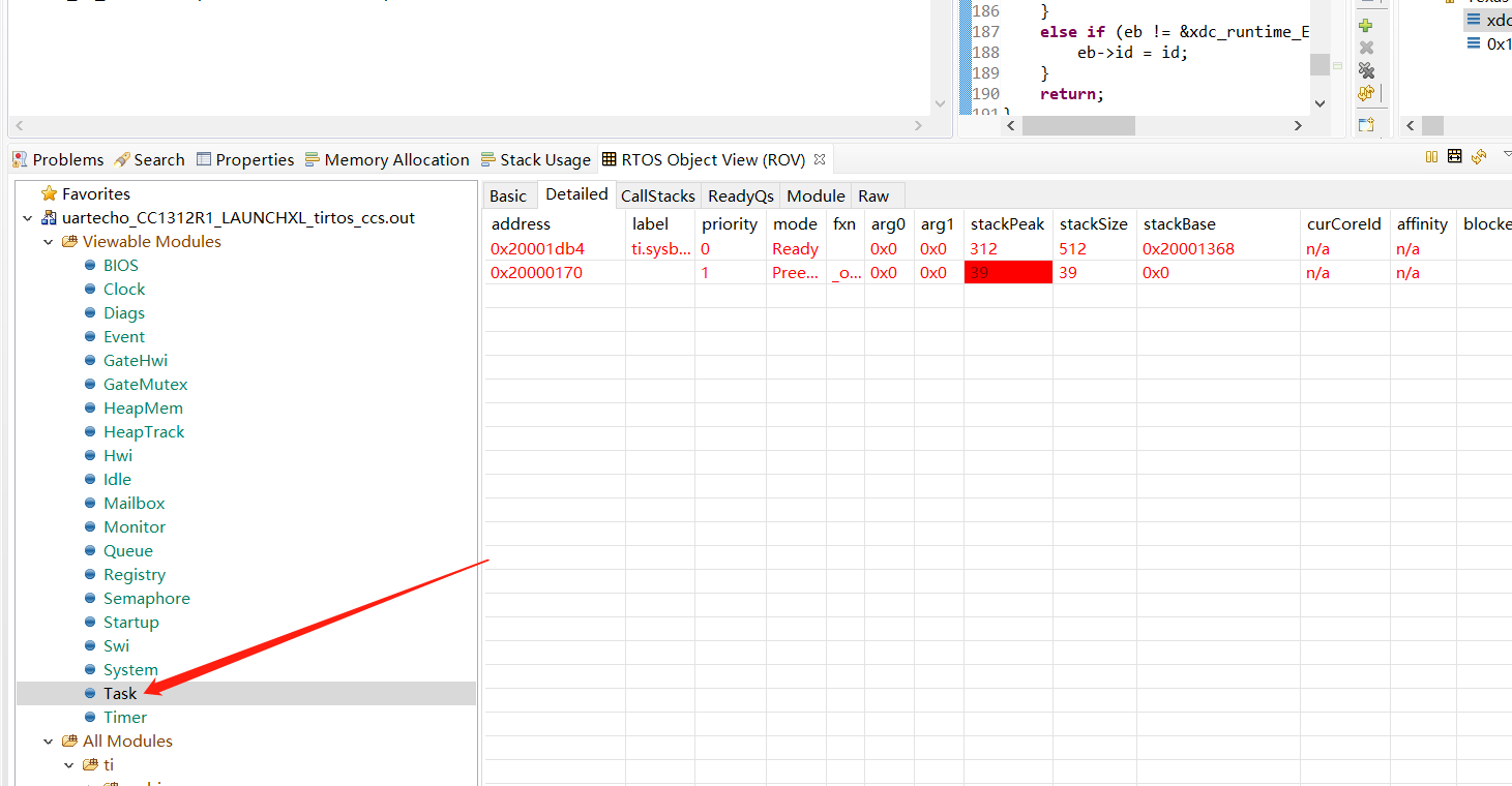

I am working on cc1312 customer board.
we find our program will jump into error poilcy very often,
according to one of your PE
"I would try to comment out the "pinrt_debug_uart" and see if that "fixes" it. sprintf for example could require quite some stack and if your main task stack is to small, you might end up experiencing a stack overflow. Could you check the stacks of your task as well?"
how can we check this
and any more idea ?
how to adjust the stack/heap size?
