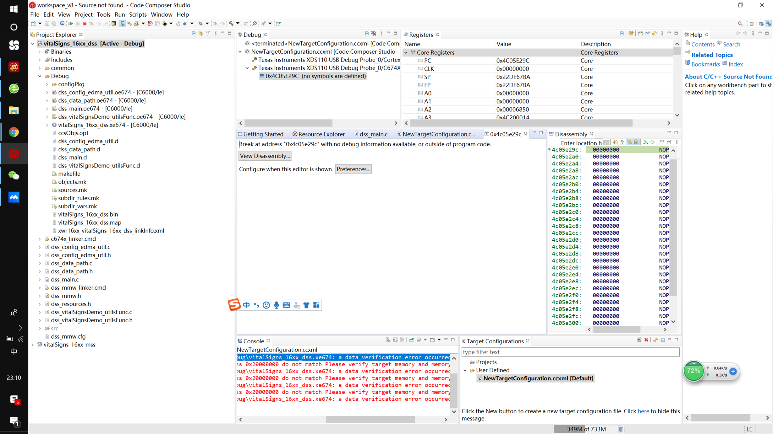

CCS/AWR1642BOOST: C674X_0: Error connecting to the target: (Error -6305) PRSC module failed to write to a router register. (Emulation package 9.2.0.00002)
Part Number: AWR1642BOOST
Other Parts Discussed in Thread: AWR1642, UNIFLASH
Dear sir/madam,
I've also have the same problem when i follow the developer's guild of MMWave AWR1642Boost.
could you please how to use the patch or how to change the register?
Thanks in advance,
Yi
