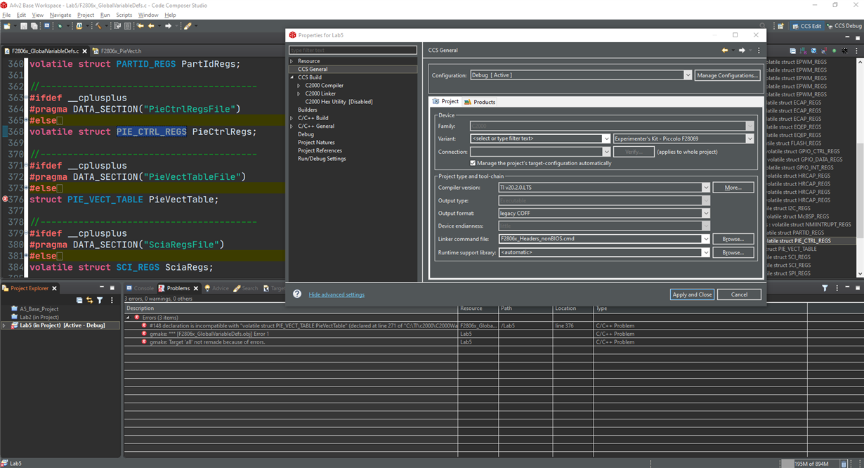

  • The full message is:
    148 declaration is incompatible with "volatile struct PIE_VECT_TABLE PieVectTable" (declared at line 271 of "C:\TI\c2000\C2000Ware_3_02_00_00\device_support\f2806x\headers\include\F2806x_PieVect.h")
    - Attached below is the whole project zip, there can be found the c and h files.
    - Trying to make the struct volatile (volatile struct SCI_REGS SciaRegs) ,
      like all other structures in this c file, results in 10010 errors -
    #10010 errors encountered during linking
    - Besides that I've searched for the "PieVectTable" expression in project,
    and it does indeed appear multiple times, but it appears in files which are excluded currently from
    the project, and for the safe side I have also commented out these lines. The error still appears afterwards.
    Amitai

  • You DO need to have the volatile keyword in the declaration. The #10010 code doesn't really tell me anything. It basically just says that it already found an error. Can you tell me the whole linker console output?
    I couldn't import your project for some reason, but I didn't see any obvious causes looking through the code.
    Whitney
  • Are you sure about adding the "volatile"? This is the same as the original question, see what you have answered there:
    I'm attaching the console output for rebuilding the project, first with the "volatile" keyword, then without:

    Building file: "../F2806x_GlobalVariableDefs.c"
    Invoking: C2000 Compiler
    "C:/TI/ccs1000/ccs/tools/compiler/ti-cgt-c2000_20.2.0.LTS/bin/cl2000" -v28 -ml -mt --cla_support=cla0 --float_support=fpu32 --vcu_support=vcu0 --include_path="C:/P4/Engineering/FirmWare/TI Development Kit/C28x workgroup/Labs/Lab5/Project" --include_path="C:/TI/c2000/C2000Ware_3_02_00_00/device_support/f2806x/headers/include" --include_path="C:/TI/ccs1000/ccs/tools/compiler/ti-cgt-c2000_20.2.0.LTS/include" -g --diag_warning=225 --diag_wrap=off --display_error_number --abi=coffabi --preproc_with_compile --preproc_dependency="F2806x_GlobalVariableDefs.d_raw"  "../F2806x_GlobalVariableDefs.c"
    >> Compilation failure
    subdir_rules.mk:16: recipe for target 'F2806x_GlobalVariableDefs.obj' failed
    "../F2806x_GlobalVariableDefs.c", line 377: error #148: declaration is incompatible with "volatile struct PIE_VECT_TABLE PieVectTable" (declared at line 271 of "C:\TI\c2000\C2000Ware_3_02_00_00\device_support\f2806x\headers\include\F2806x_PieVect.h")
    1 error detected in the compilation of "../F2806x_GlobalVariableDefs.c".

  • Both GlobalVariableDefs.c and PieVect.h need to say volatile struct PIE_VECT_TABLE PieVectTable so that they match to get rid of that error (although PieVect.h will be extern). I don't know why the recommendation in the other thread was to remove the volatile--the files in the latest C2000Ware have the volatile and those examples build fine, so that should be correct.
    Please tell me what error messages remain once you have the volatile added.
    Whitney
  • When both the GlobalVariableDefs.c and PieVect.h are volatile struct PIE_VECT_TABLE PieVectTable,
    (PieVect.h isn't "extern") the output is as follows:

  • The vector table does need to be extern in PieVect.h. I suspect that's why you're getting that redefined symbol error.
    I see PieCtrl.c in the files you've shared. In CCS, do you see it in the project? It should be able to find InitPieCtrl() in that file as long as it's part of the project.
    You're also getting an error about .ebss not fitting into memory. If you aren't sure how to fix it, check out the Linking section of the compiler guide.
    http://www.ti.com/lit/pdf/spru514
    Whitney
  • Thanks Whitney,
    When changing to
    extern volatile struct PIE_VECT_TABLE PieVectTable;
    there's no difference, the exact same error appears.
    I'm following carefully the instructions for the lab, which currently direct -
    Do not add DefaultIsr_5.c, PieCtrl.c, and PieVect.c. These files will be
    added and used with the interrupts in the second part of this lab exercise.
    and so I have done.
    I've tried before adding these files, and more errors appear.
    Might is be that there is some problem with the project files? can someone in TI get into it?
    As I've mentioned, I have followed carefully the instructions, I don't think it is something
    I am doing wrong in the configuration.
    Amitai
  • After commenting out a "InitPieCtrl();" function in the main.c file no errors appear,
    I don't know if this is considered a solution to the problem.
    Amitai
  • I think it depends on what step in the lab 5 you're on. The first half of the lab, you don't need PieCtrl.c or a call to the function. It looks like starting with step 18 in the lab guide it tells you to add the files and the function call.
    Whitney
