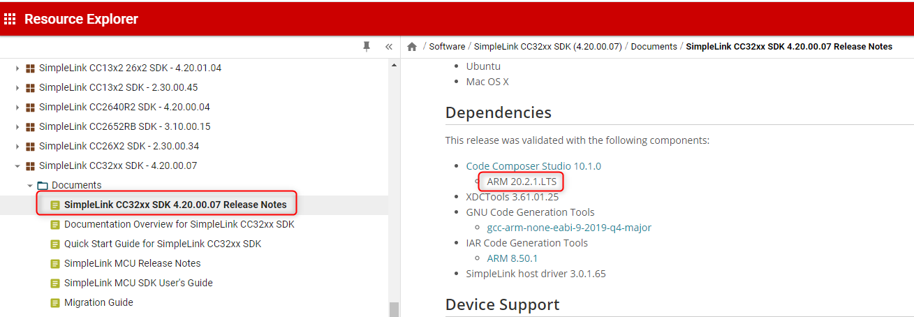

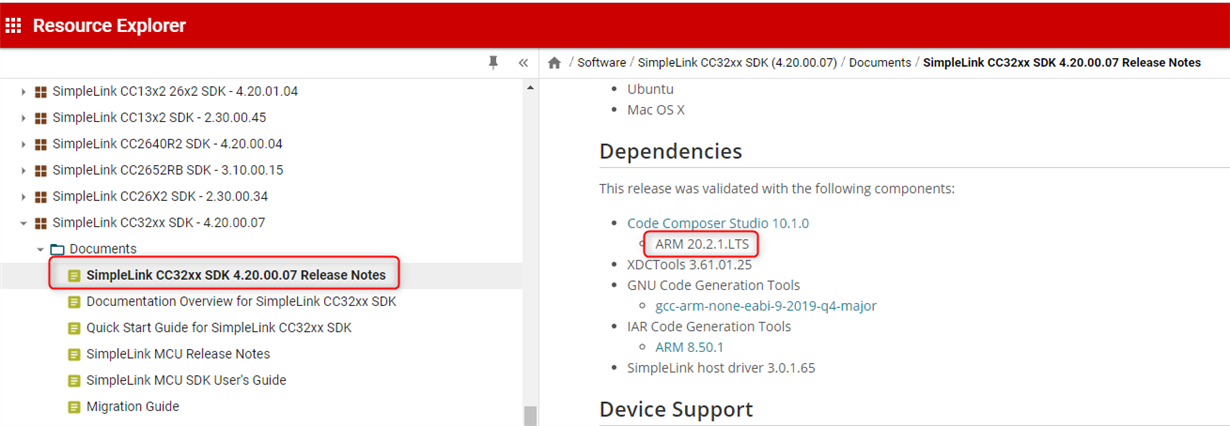

Sterling Harris said:Already set up the FREERTOS_INSTALL_DIR environment variable
That should be the only thing you need to do after importing the example.
Sterling Harris said:Running ARM compiler TI v18.12.6.LTS
I get the same error when using 18.12.6.
When I use 20.2.1 (which comes with CCS 10.1), the issue goes away. Looks like the new SDK has a dependency on 20.2.1 and CCS 10.1. Check the release notes:
https://dev.ti.com/tirex/explore/node?node=AB1x.3sSEeowssfYLg8J4g__fc2e6sr__LATEST
ki
