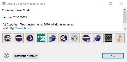

Hmmm.. that is fairly old version. Any chance you can upgrade your CCS version?
In any case, I did try with CCS 7.4.0. But I was still unable to reproduce the issue. What versions of xdctools and SYS/BIOS are being used with the project?

Yes, the project is a fork of NIMU example, and i have warning of ,
Description Resource Path Location Type
This project was created with a newer version of Code Composer Studio - v7.4.0. It is recommended that you upgrade to v7.4.0, or newer version of Code Composer Studio, to ensure optimal compatibility. NIMU_attempt project Problems
But i use it with CCS 7.2, let me check if it's really the issue. Thanks.
