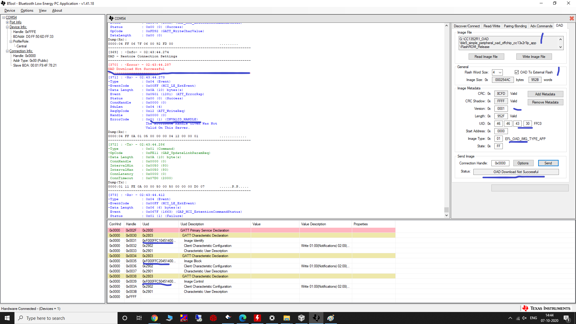

  • HI Marie H,
    As you suggested I tried to run the sample OAD application in the example using BTOOL but I'm getting OAD Download Not Successful Message every time.
    i followed as like mentioned in the document, Here is the link
    file:///C:/ti/simplelink_cc13x2_sdk_2_20_00_71/docs/ble5stack/ble_user_guide/html/oad/oad_offchip.html
    Used Two Launchpads of CC1352R1(C revision IC's Old one),
    One is loaded with Host_Test Hex file from C:\ti\simplelink_cc13x2_sdk_2_20_00_71\examples\rtos\CC1352R1_LAUNCHXL\ble5stack\hexfiles\cc13x2r1/ble5_host_test_cc13x2r1lp_app_FlashROM_Release
    Second Board is Loaded with the below process
    Step 1: flashed cc13x2r1lp_bim_offchip.
    Step 2: flashed ble5_simple_peripheral_oad_offchip_cc13x2r1lp_stack_library
    Step 3: flashed ble5_simple_peripheral_oad_offchip_cc13x2r1lp_app.
    Then I Connected my CC2540 Dongle.
    Btool - BLE PC Application V1.41.18
    CCS Version :9.1
    SDK Used :simplelink_cc13x2_sdk_2_20_00_71
    BTOOL is connected successfully with peripheral application Device, then I started OAD Process by read the image as like below screen shot.
    As I observed that all OAD profiles are not happening properly.
    I have changed  some of parameters in BTOOL but it wont work for me, and I unable to find out that where exactly problem lies
    Please check that image and suggest me to any changes are need for BTOOL configuration for OAD.
    Harikrishna Paritala

  • Hi Harikrisna,
    I'm sorry I can't help you if you are using the Rev C device. Please update to the newest revision (Rev E).
  • Hi Marie H,
    I tried same process already with 3.1 SDK (simplelink_cc13x2_26x2_sdk_3_10_01_11(3.10.1.11)), I observed Same results like as above, that's why roll back to older version to check my luck. But here I'm confused Because  I did same this as mention in the document.
    I Never touched any part of the code in examples, Should I need to modify anything? I able to see the BTOOL and off-chip OAD peripheral code are connected properly first time then OAD Process is stopped at same position.
    Please check this BTOOL Log and give me some help.
  • Hi Harikrishna,
    Please confirm you are using CC13x2 or CC26x2 devices with chip revision E for both the OAD target and OAD distributor.
