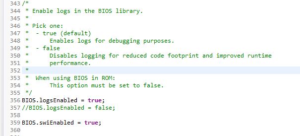

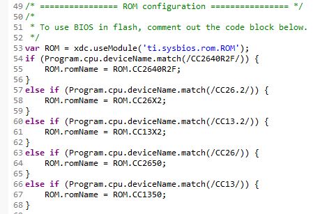

i had an Question in the Wrong forum, so i repost here.
Hey,
my Execution Graph is not showing Data.
In my RTOS Object View under LoggerStopMode there is also no data, which leads me to a wrong configuration of *.cfg,
In my .cfg I changed everything as described in http://dev.ti.com/tirex/explore/content/simplelink_academy_cc13x2_26x2sdk_4_20_03_00/modules/rtos/tirtos_basics/tirtos_basics.html#task-2-debugging-tools
Any ideas what i configured wrong ?
