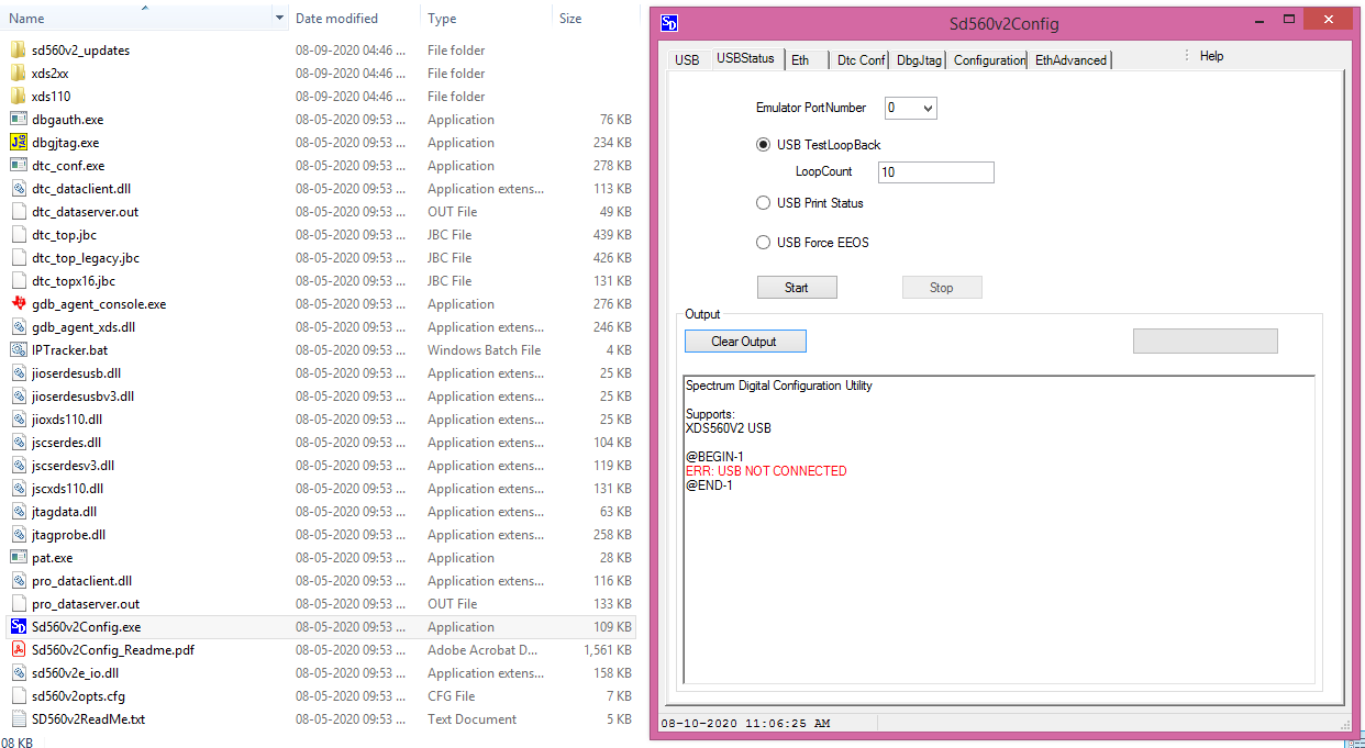

While connecting TDA2x board with Spectrum Digital XDS560v2 STM USB emulator , JTAG connection is not detected. I am using CCSv10. I have attached the log related to the issue:
[Start: Spectrum Digital XDS560V2 STM USB Emulator_0]
Execute the command:
%ccs_base%/common/uscif/dbgjtag -f %boarddatafile% -rv -o -F inform,logfile=yes -S pathlength -S integrity
[Result]
-----[Print the board config pathname(s)]------------------------------------
C:\Users\nawin.ks\AppData\Local\TEXASI~1\
    CCS\ccs1010\0\0\BrdDat\testBoard.dat
-----[Print the reset-command software log-file]-----------------------------
This utility has selected a 560/2xx-class product.
This utility will load the program 'sd560v2u.out'.
E_RPCENV_IO_ERROR(-6) No connection: DTC_IO_Open::dtc_conf
Download failed for file C:\ti\ccs1010\ccs\ccs_base\common\uscif\xds560v2.out
An error occurred while soft opening the controller.
-----[An error has occurred and this utility has aborted]--------------------
This error is generated by TI's USCIF driver or utilities.
The value is '-250' (0xffffff06).
The title is 'SC_ERR_ECOM_EMUNAME'.
The explanation is:
An attempt to access the debug probe via USCIF ECOM has failed.
[End: Spectrum Digital XDS560V2 STM USB Emulator_0]

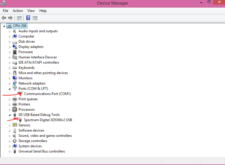

Device manager screenshot:
Please Help with this.
