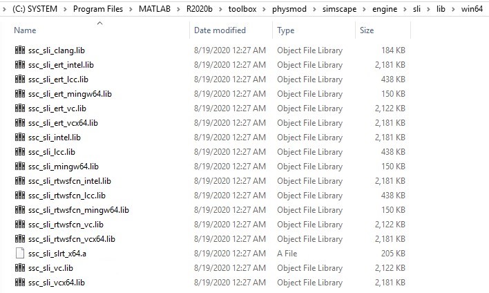

  • Hi John,
    Thanks for following up.
    Here's the contents of the directory at the location of the missing files. All the libraries are named ssc_sli_<something>.lib
    It appears the linker lines are truncated. I reinstalled MATLAB to C:\MATLAB to remove spaces and shorten the path and confirmed the new path in the linker. The build errors were still the same.

  • Chester Gillon said:
    I don't have the required MATLAB toolbox licenses to check, but I think those libraries are all for Windows compilers.
    I found a license to install Simscape.
    All of the library files in the C:\Program Files\MATLAB\R2020b\toolbox\physmod\simscape\engine\sli\lib\win64 directory are for Intel (either 32 or 64 bits). objdump reports the following file formats:
    • elf64-x86-64
    • pe-i386
    • pe-x86-64
