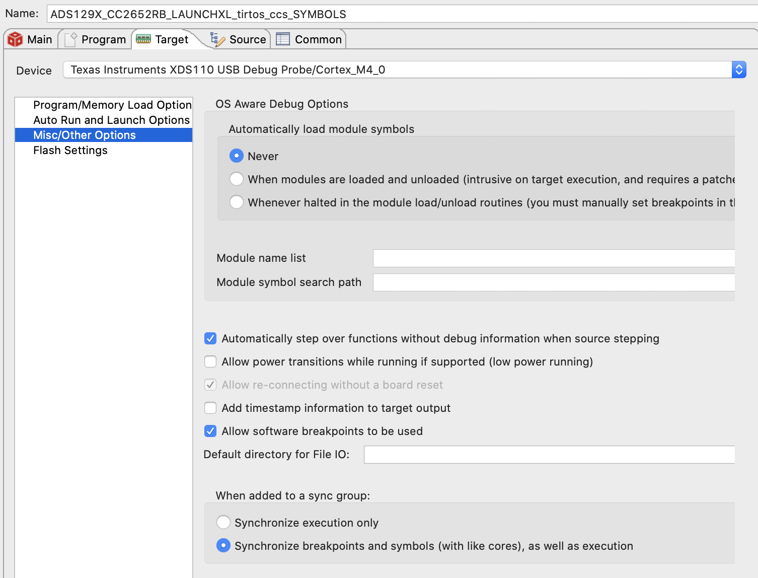

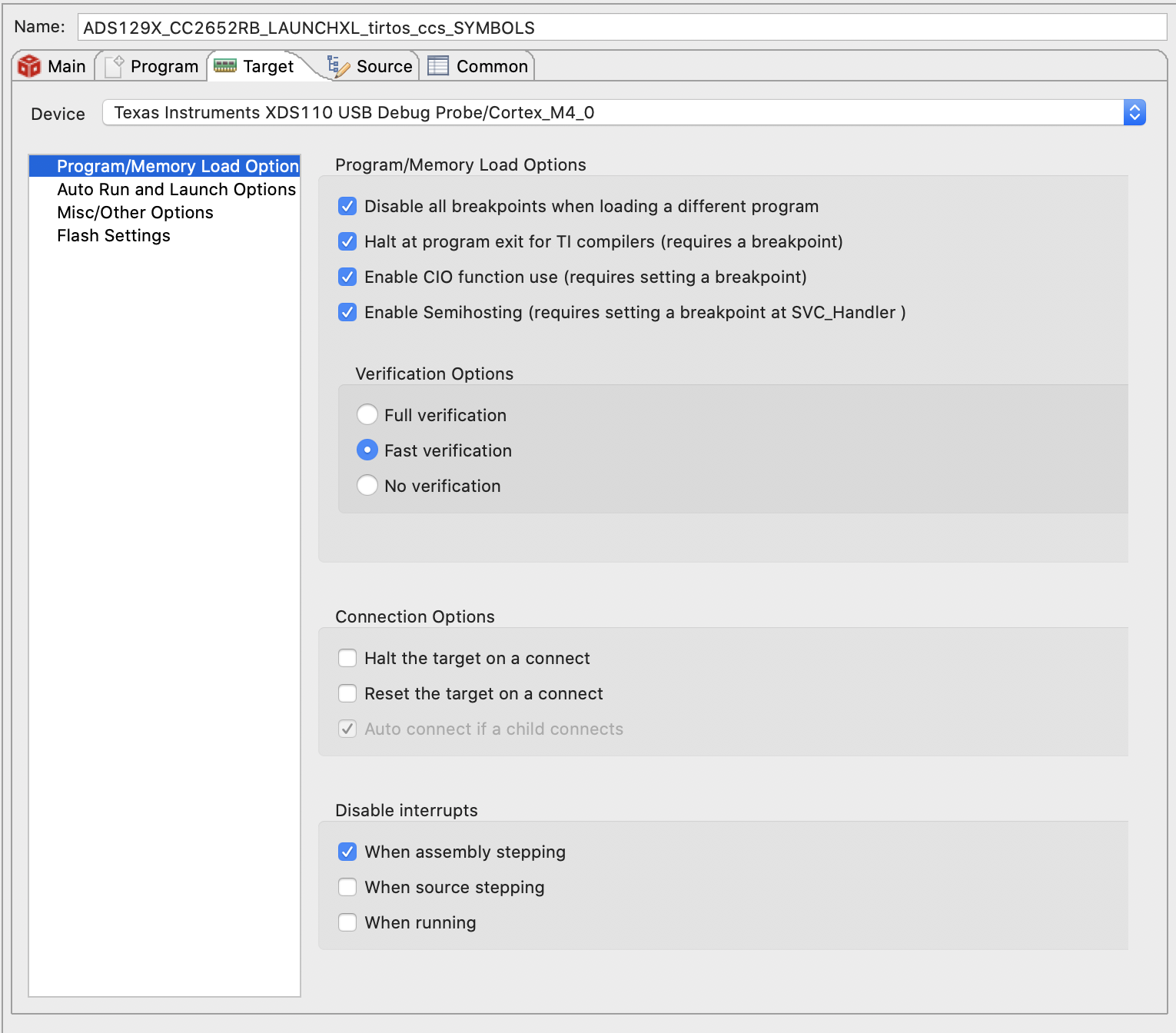

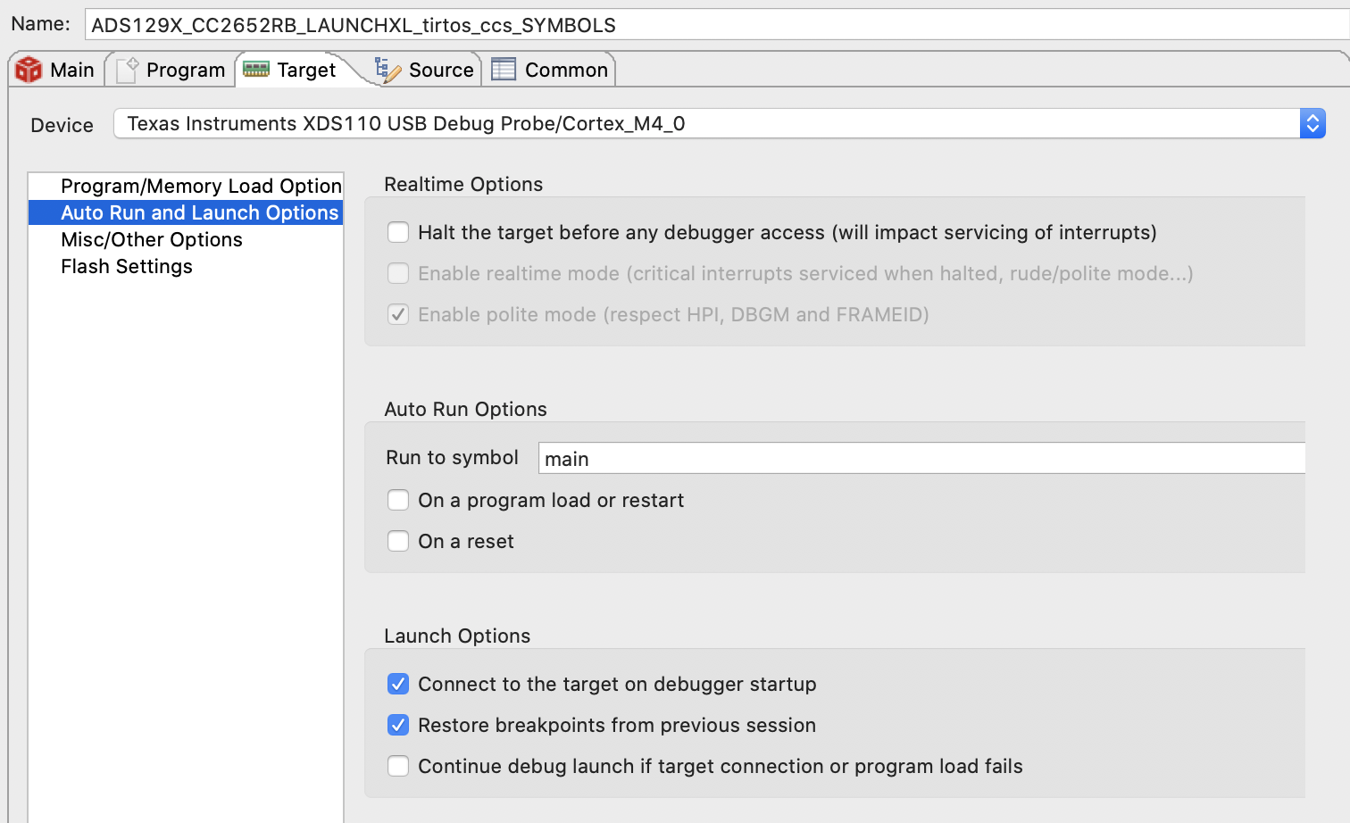

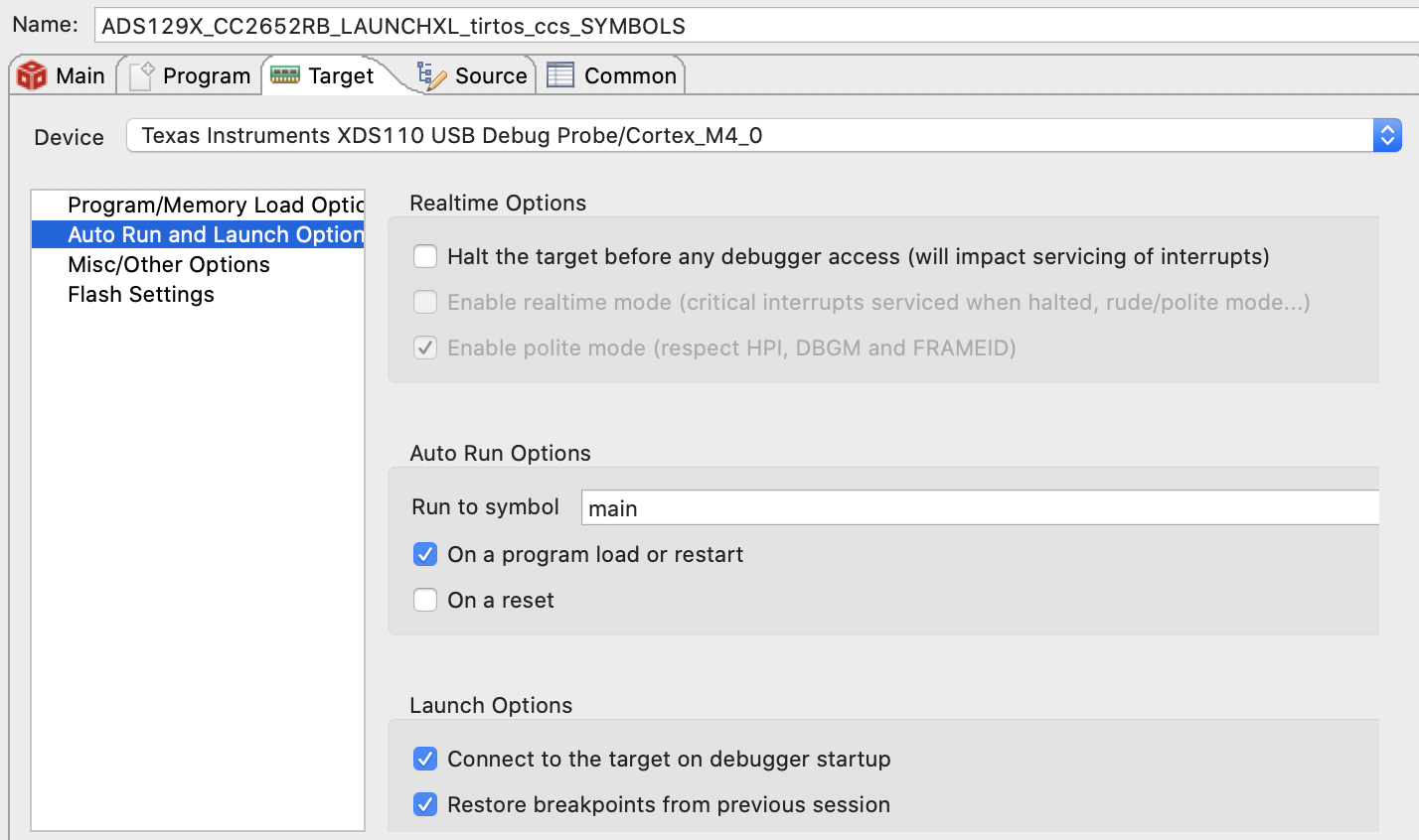

  • Ki, thanks, but I'm not any closer. I have "Halt the target on a connect" disabled. I cleared up some of my confusion by clicking on the core itself in the debug view. It still appears my device stops immediately upon debugging. If I click pause, then play, I can debug the program as expected, but I'm still left with a device that was reset. Ideally, I can enter a debug mode and observe how many times a counter has been increased after a week of running.
    Here are all the tabs:

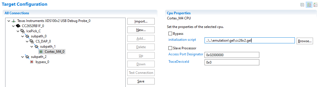

    I just created a new target configuration file for a CC2652RB1F, and found that a GEL file was specified as an initialisation script:
    Looking at the selected GEL file (C:\ti\ccs1011\ccs\ccs_base\emulation\gel\cc26x2.gel in a CCS 10.1.1 installation) it has the following:
    StartUp(int major, int minor, int patch)
        /* Initialize memory map */
        memorymap_init();
        /* Debugger specific handling */
        if(GEL_MatchesConnection(".*TIXDS.*") == 1)
            GEL_LoadGel("$(GEL_file_dir)/cc26xx_connect_util.gel");
            GEL_LoadGel("$(GEL_file_dir)/cc26x2_xds.gel");
            DefineResets(0);
            // Issue Board Reset to ensure device is in a known state
            // Note: If you want to attach to a running target without resetting the
            //       device, you must comment out the following 4 lines:
            if(!GEL_IsConnected())
                GEL_AdvancedReset("Board Reset");
    If your target configuration is using that default GEL file, it would explain the source of the reset when connecting to a running target.
