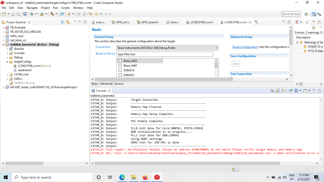

I'm struggling to run baremetal applications. First i had problems with the linkers, and now finally passed that phase and i get:
C674X_0: File Loader: Verification failed: Values at address 0x00700001 do not match Please verify target memory and memory map.
C674X_0: GEL: File: C:\Users\afons\Desktop\tese\workspace_v9\ledblink_baremetal\Debug\ledblink_baremetal.out: a data verification error occurred, file load failed.
My rtsc app works but i don't no why i can't get the Led's to change state, so i'm trying to do it in a baremetal app.
It seems like the code is uploaded to the board and it initializes, then this error occurs.

  • Afonso,
    Looking at the memory map defined in the GEL file for the C6748 LCDK it looks like 0x00700001 is ROM.
    GEL_MapAddStr( 0x00700000, 0, 0x00100000, "R|W|AS4", 0 );   // DSP L2 ROM
    Same when I look at the default linker command file:
        DSPL2ROM     o = 0x00700000  l = 0x00100000   /* 1MB L2 Internal ROM */
    Is your program placing something there?  Can you check the linker command (.cmd) file in the project to see if it is placing something there?  The .map file in the \Debug folder should also show if anything is being placed there.
    John

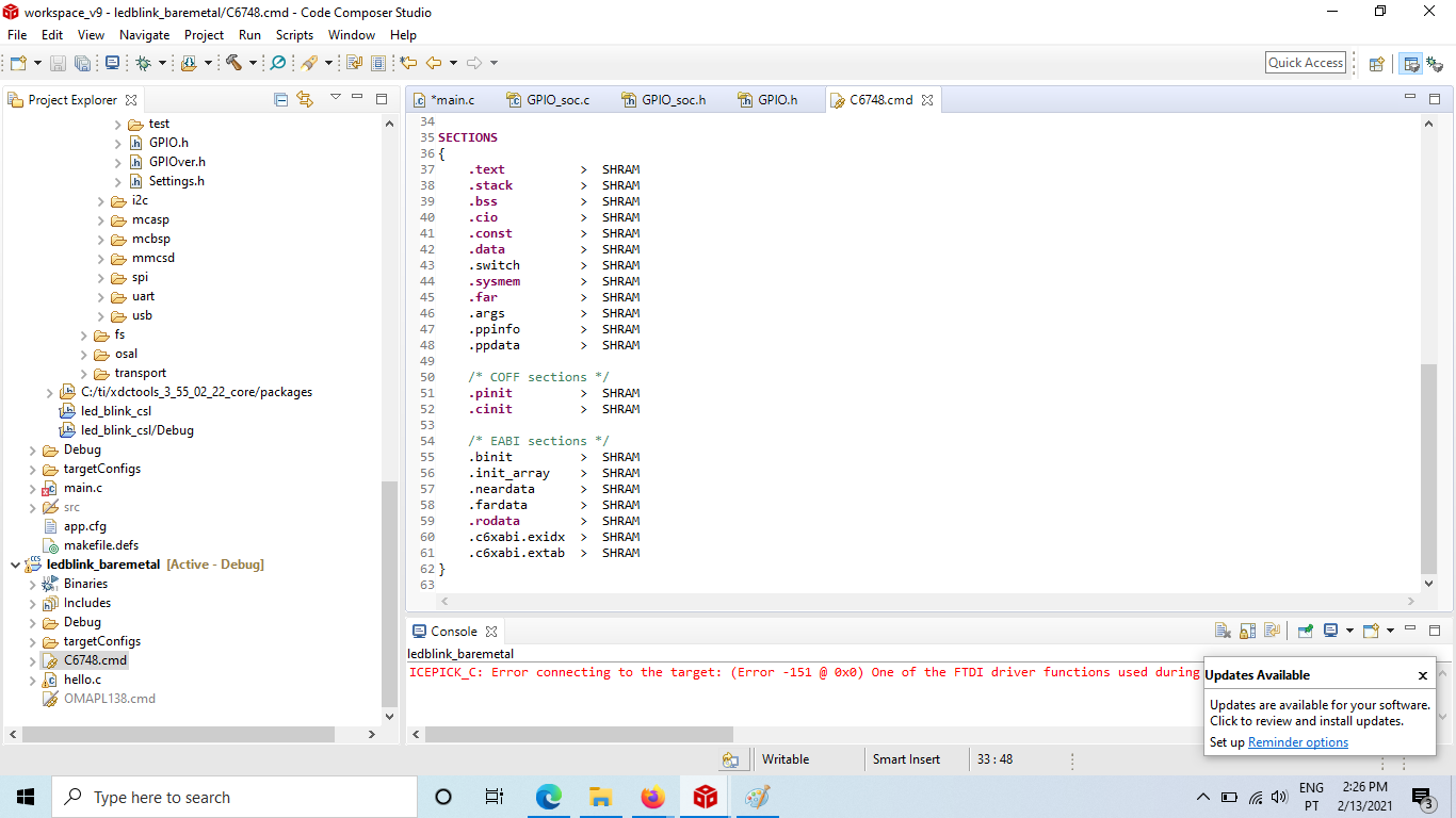

  • Is the linker reporting any warnings of the form warning #10247-D: creating output section "<section_name>" without a SECTIONS specification ?
    If so, the linker will place the section in a "random" memory region which leads to errors when trying to load or run the program.

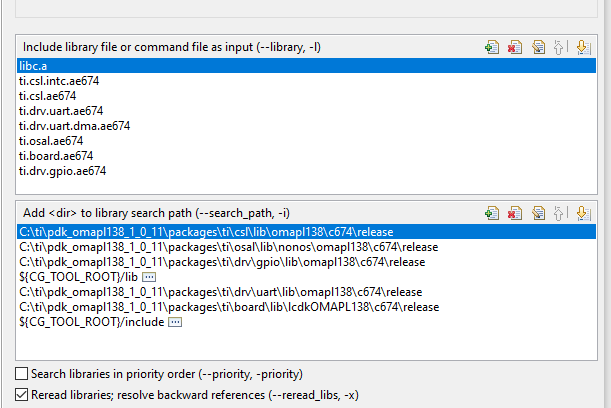

  • I think it might have to do with the libraries i chose in linking...
    But yes, the ROM is in that address, but i don't know if any program is being loaded there, doesn't seem like it
  • No, Im not getting that error, what happens is shown in the secttion above, the board initializes and i get that error.
    Maybe it has something to do with the .ae674 files i used?

  • This was not the right file, sorry, yes the ROM seems to be used, but it is not suposed to?
                   TMS320C6x Linker PC v8.3.5
    >> Linked Fri Feb 12 19:06:27 2021
    OUTPUT FILE NAME:   <ledblink_baremetal.out>
    ENTRY POINT SYMBOL: "_c_int00"  address: 8000d1a0
    MEMORY CONFIGURATION
             name            origin    length      used     unused   attr    fill
      DSPL2ROM              00700000   00100000  00000220  000ffde0  RWIX
      DSPL2RAM              00800000   00040000  00000000  00040000  RWIX
      DSPL1PRAM             00e00000   00008000  00000000  00008000  RWIX
      DSPL1DRAM             00f00000   00008000  00000000  00008000  RWIX
      SHDSPL2ROM            11700000   00100000  00000000  00100000  RWIX
      SHDSPL2RAM            11800000   00040000  00000000  00040000  RWIX
      SHDSPL1PRAM           11e00000   00008000  00000000  00008000  RWIX
      SHDSPL1DRAM           11f00000   00008000  00000000  00008000  RWIX
      EMIFACS0              40000000   20000000  00000000  20000000  RWIX
      EMIFACS2              60000000   02000000  00000000  02000000  RWIX
      EMIFACS3              62000000   02000000  00000000  02000000  RWIX
      EMIFACS4              64000000   02000000  00000000  02000000  RWIX
      EMIFACS5              66000000   02000000  00000000  02000000  RWIX
      SHRAM                 80000000   00020000  00011db6  0000e24a  RWIX
      DDR2                  c0000000   20000000  00000000  20000000  RWIX
    SEGMENT ALLOCATION MAP
    run origin  load origin   length   init length attrs members
    00700000    00700000    00000220   00000220    r-x
      00700000    00700000    00000220   00000220    r-x .csl_vect
