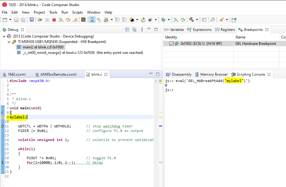

I can set a breakpoint in my GEL files using GEL_HWBreakPtAdd("<function>");
I can set a breakpoint inside a function by right-clicking on the line.
I have not found a way to set a breakpoint on a line or a label using a GEL function.
Is this possible?
I have tried
GEL_HWBreakPtAdd("mysource.c:78");
GEL_HWBreakPtAdd("mysource.c, line 78");
GEL_HWBreakPtAdd("mysource.c", 78);
but neither is consider a valid breakpoint.
Is is possible, if paths are added?
but can I automatically run a DSS script when I connect in the debugger?
I haven't tried it myself, but the Initialization Script field in the Debug Configurations allows a DSS JavaScript to be specified to be run during debug launch. The video linked from that page shows a .js file being used to set a breakpoint at a specific source file and line number.
Do you have an example of setting a breakpoint to a label using GEL?
Try:
GEL_HWBreakPtAdd("<label>")
Yes, Chester is correct. Just in case you missed it (it can be hard to see sometimes), the "Debug Configurations" text in Chester's post is a hyperlink.
