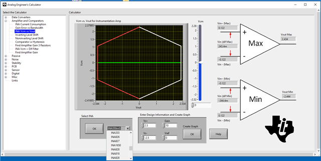

Analog Engineer's Calculator, disabled list of instrumentation amplifiers in "vcm vs vout" calculator
Fresh installation in Windows 10, when selecting the "vcm vs vout" calculator a message window with a "Supply or Ref voltage out of Range" warning appears, and the "Select INA" list is empty (cannot select amplifier).
This Windows 10 install is a virtual guest on a Linux server, but I don't think that matters.

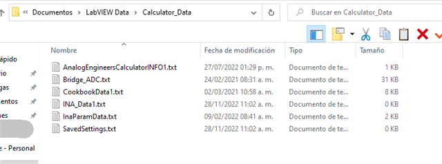

  • Checking the Documents / LabVIEW Data / Calculator_Data folder, there is a file name "INA_Data1.txt" empty (0 bytes). I read on the other thread that the calculator may try to download some data on startup. Maybe this is the cause.

  • I found the problem. In our network Internet access has to pass thru a proxy server. It seems the Calculator software, on startup, tries to connect to a server named "software-dl.ti.com", but ignores the Windows proxy configuration.
    I had to ask for temporary permissions for this Windows machine to be able to connect bypassing the proxy server.
    Now, the "INA_Data1.txt" file size is around 14 kbytes and it contains parameters for the available amplifiers, and the calculator seems to work correctly.
    After the access is again allowed only thru the proxy server, it seems the calculator tries to access the remote server unsuccessfully but at least preserves the already populated "INA_Data1.txt" file.
