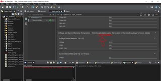

I am starting to work on Offline solar UPS and reference design from TI is “ TI DAB 10KW TIDA 010054”.
I looking for video tutorial/documents for TMS320F280049 controller which explains the clocks, peripherals and PWM to execute the project.
Also please share the calculations.xlsx sheet, mentioned in the main.syscfg as shown in attached image.
Thanks in advance.
    Thanks for reaching out. The reference design is documented in the TIDA-010054 Design Guide, which can be found on https://www.ti.com/tool/TIDA-010054/ under design files.
    We do not have a video tutorial for TIDA-010054.
    I attached the missing calculations excel file.
