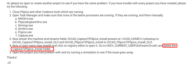

Hi team,
One of our customers is experiencing the same problem as the "Original question". He has the same problem with every project he opens or creates.
He has tried the solution in the 'Original question', but did not see the folder(CaptureTIPSpice_Install) in the directory (HKEY_CURRENT_USER\Software\Orcad\) in step 4. So what should we do?
