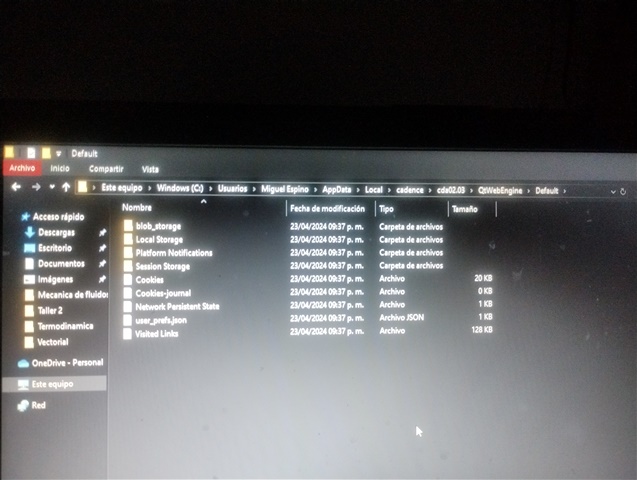

Hi Miguel,
Do you know if you are on 17.4-S009, or 23.1-S001?

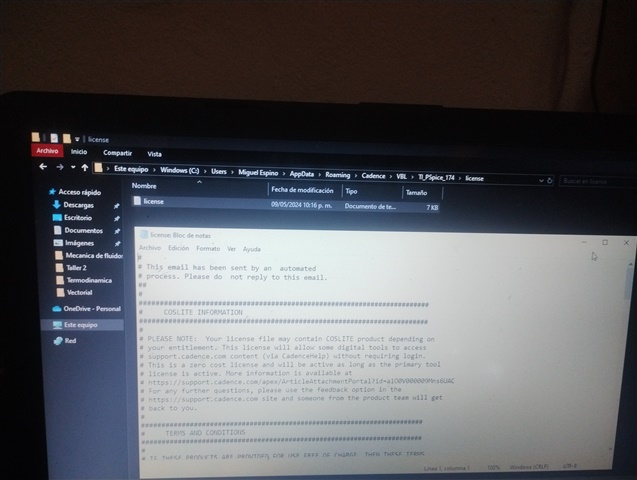

Can you check the following path:
%appdata%\Cadence\VBL
There should be a directory TI_PSpice_231 and/or TI_PSpice_174.

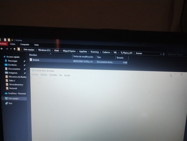

Please check into whichever is the most recent (should be 231). License, and in there should be a license.txt
Can you also post (Insert->Image/video/file) the file cdsPspiceTIlog.txt at %appdata%\Cadence\PSpiceTIInstall
David

Hi Miguel,
Looks like your system tried to do an update and something went wrong.
Please try the following:
1. Uninstall PSpice for TI
2. Reboot your computer
3. Re-install PSpice for TI.
If you can't find your installer, you can put in a request at www.ti.com/tool/PSPICE-FOR-TI
It'll send you your access key (which won't change from before) and a link to the download. I'd recommend doing this.
David
