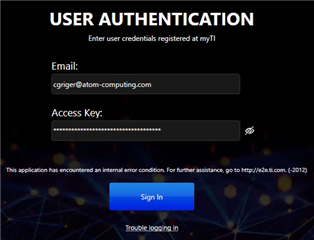

I am trying to run PSPICE-FOR-TI from a cloud PC running Windows 11, but when I enter my e-mail and Access Key, the application runs into an internal error condition (-2012) and advises to seek assistance on this forum.
I did find another issue that appeared to be similar, but I do not have the same issue with a lack of a serial number.
https://e2e.ti.com/support/tools/simulation-hardware-system-design-tools-group/sim-hw-system-design/f/simulation-hardware-system-design-tools-forum/1426562/pspice-for-ti-user-authentication---the-application-has-encountered-an-internal-error-condition-err-code--2008
I've included the output of the commands that were requested from the other thread below.  Please let me know what next steps I should follow to try to get this to work.
Thanks!
Chris

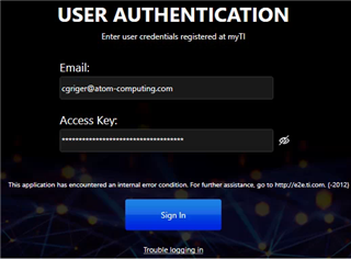

  • Hi David - the 4 day weekend sounds great, but I'm sorry to hear that you got food poisoning.
    I just checked again and I am still getting the same error when I try to run the installer.
    I have also tried running this in Windows 8 compatibility mode and running it as an Administrator, both of which fail with the same error.
    Do you have any ideas or additional things that I should check on my system?

    1:42:49 PM Thursday, February 13, 2025 : Response Content length = 1766
    1:42:49 PM Thursday, February 13, 2025 : C:\Users\ControlSystemsGroup\AppData\Roaming\Cadence\PspiceTIInstall\TI_URLs.txt bytes downloaded = 1766
    1:42:49 PM Thursday, February 13, 2025 : Reading Json URL File
    1:42:49 PM Thursday, February 13, 2025 : setting media download server URL from Json File
    1:42:49 PM Thursday, February 13, 2025 : setting default production Dll server URL
    1:42:49 PM Thursday, February 13, 2025 : Chws URL is: https://cdsplicwc.cadence.com/chws/b2c/v2
    1:42:49 PM Thursday, February 13, 2025 : DownloadServerPath is: https://software-dl.ti.com/pspice/esd/installer
    1:42:49 PM Thursday, February 13, 2025 : ReleaseVersion in XML: 23.10.001 InstalledVersion on system:
    1:42:49 PM Thursday, February 13, 2025 : LaunchTIPSpiceDlgs()
    1:42:49 PM Thursday, February 13, 2025 : Checking for compnts.dat
    1:43:08 PM Thursday, February 13, 2025 : error_code cdsVblAuthenticateUser: VblSuccess
    1:43:08 PM Thursday, February 13, 2025 : error_code cdsVblRegisterInstallation: VblInternalError
    1:43:08 PM Thursday, February 13, 2025 : strErrorMsgDesc: This application has encountered an internal error condition. For further assistance, go to http://e2e.ti.com. (-2012)
    1:43:18 PM Thursday, February 13, 2025 : error_code cdsVblAuthenticateUser: VblSuccess
    1:43:18 PM Thursday, February 13, 2025 : error_code cdsVblRegisterInstallation: VblInternalError
    1:43:18 PM Thursday, February 13, 2025 : strErrorMsgDesc: This application has encountered an internal error condition. For further assistance, go to http://e2e.ti.com. (-2012)
    2:11:03 PM Thursday, February 13, 2025 : error_code cdsVblAuthenticateUser: VblSuccess
    2:11:03 PM Thursday, February 13, 2025 : error_code cdsVblRegisterInstallation: VblInternalError
    2:11:03 PM Thursday, February 13, 2025 : strErrorMsgDesc: This application has encountered an internal error condition. For further assistance, go to http://e2e.ti.com. (-2012)

    	"LibUpdate_UpdateDelta": "https://software-dl.ti.com/pspice/esd/models/library/UpdateDelta.json",
    	"LibUpdate_UpdateConfig": "https://software-dl.ti.com/pspice/esd/models/library/UpdateConfigure.json",
    	"LibUpdate_LibMetadata": "https://software-dl.ti.com/pspice/esd/models/library/library.json",
    	"LibFirstInstall_LibraryZip": "https://software-dl.ti.com/pspice/esd/models/library/library.zip",
    	"LibFirstInstall_LatestVersion": "23.10.001",
    	"Installer_DownloadXML": "https://software-dl.ti.com/pspice/esd/installer/setup/PSpiceForTIXML.xml",
    	"Installer_BasePath": "https://software-dl.ti.com/pspice/esd/installer",
    	"Installer_DownloadSetup": "https://software-dl.ti.com/pspice/esd/installer/setup/PSpice-For-TI_setup.exe",
    	"Licensing_URL": "https://cdsplicwc.cadence.com/chws/b2c/v1",
    	"SoftwareUpdate_Expiry": {
    		"Timestamp": "01:15:2099 15:07:19 GMT",
    		"RegularMessage": {
    			"PreHyperLink": "A new software update is available. Click Install to start the download. By installing the update, you accept the ",
    			"HyperLink": "license agreement",
    			"PostHyperLink": "."
    		"ForceMessage": {
    			"PreHyperLink": "Latest updates must be installed to run the software. Click Install to start the download. By installing the update, you accept the",
    			"PostHyperLink": ".  Click Cancel to exit."
    	"UTM_Keyword": {
    		"TIPSpice_Install": "HQS=pspiceforti",
    		"Full_Install": "HQS=pspiceforti"
    	"TI_URLs_Version": [
    		"17_4_2020_S006",
    		"17_4_2020_S009",
    		"23_1_2024_S001"
    9:01:03 AM Friday, February 14, 2025 : Checking if Licensing URL is accessible
    9:01:03 AM Friday, February 14, 2025 : Initializing
    9:01:03 AM Friday, February 14, 2025 : Deleting file : C:\Users\ControlSystemsGroup\AppData\Roaming\Cadence\PspiceTIInstall\TI_URLs.txt
    9:01:03 AM Friday, February 14, 2025 : Downloading URLs file from : https://pcb.cadence.com/startPages/PSpiceTI_data/TI_URLs.txt
    9:01:03 AM Friday, February 14, 2025 : Response Content length = 1766
    9:01:03 AM Friday, February 14, 2025 : C:\Users\ControlSystemsGroup\AppData\Roaming\Cadence\PspiceTIInstall\TI_URLs.txt bytes downloaded = 1766
    9:01:03 AM Friday, February 14, 2025 : Reading Json URL File
    9:01:03 AM Friday, February 14, 2025 : setting media download server URL from Json File
    9:01:03 AM Friday, February 14, 2025 : setting default production Dll server URL
    9:01:03 AM Friday, February 14, 2025 : Chws URL is: https://cdsplicwc.cadence.com/chws/b2c/v2
    9:01:03 AM Friday, February 14, 2025 : DownloadServerPath is: https://software-dl.ti.com/pspice/esd/installer
    9:01:04 AM Friday, February 14, 2025 : ReleaseVersion in XML: 23.10.001 InstalledVersion on system:
    9:01:04 AM Friday, February 14, 2025 : LaunchTIPSpiceDlgs()
    9:01:04 AM Friday, February 14, 2025 : Checking for compnts.dat
    9:01:13 AM Friday, February 14, 2025 : error_code cdsVblAuthenticateUser: VblSuccess
    9:01:13 AM Friday, February 14, 2025 : error_code cdsVblRegisterInstallation: VblInternalError
    9:01:13 AM Friday, February 14, 2025 : strErrorMsgDesc: This application has encountered an internal error condition. For further assistance, go to http://e2e.ti.com. (-2012)
    9:05:33 AM Friday, February 14, 2025 : parameter count = 1
    9:05:33 AM Friday, February 14, 2025 : -wrapper
    9:05:33 AM Friday, February 14, 2025 : Module Name: TIPSpice.exe
    9:05:33 AM Friday, February 14, 2025 : Server OS = False
    9:05:33 AM Friday, February 14, 2025 : Operating system version : 10.0.0.0
    9:05:33 AM Friday, February 14, 2025 : Checking for proxy
    9:05:34 AM Friday, February 14, 2025 : {
    	"LibUpdate_DeltaZip": "https://software-dl.ti.com/pspice/esd/models/library/delta.zip",
    	"LibUpdate_VersionTxt": "https://software-dl.ti.com/pspice/esd/models/library/Pspice_Lib_Version.txt",
    		"RegularMessage": {
    		"ForceMessage": {
    	"UTM_Keyword": {
    		"17_4_2020_S006",
    		"17_4_2020_S009",
    		"23_1_2024_S001"
    9:05:34 AM Friday, February 14, 2025 : Checking if Licensing URL is accessible
    9:05:34 AM Friday, February 14, 2025 : Initializing
    9:05:34 AM Friday, February 14, 2025 : Deleting file : C:\Users\ControlSystemsGroup\AppData\Roaming\Cadence\PspiceTIInstall\TI_URLs.txt
    9:05:34 AM Friday, February 14, 2025 : Downloading URLs file from : https://pcb.cadence.com/startPages/PSpiceTI_data/TI_URLs.txt
    9:05:34 AM Friday, February 14, 2025 : Response Content length = 1766
    9:05:34 AM Friday, February 14, 2025 : C:\Users\ControlSystemsGroup\AppData\Roaming\Cadence\PspiceTIInstall\TI_URLs.txt bytes downloaded = 1766
    9:05:34 AM Friday, February 14, 2025 : Reading Json URL File
    9:05:34 AM Friday, February 14, 2025 : setting media download server URL from Json File
    9:05:34 AM Friday, February 14, 2025 : setting default production Dll server URL
    9:05:34 AM Friday, February 14, 2025 : Chws URL is: https://cdsplicwc.cadence.com/chws/b2c/v2
    9:05:34 AM Friday, February 14, 2025 : DownloadServerPath is: https://software-dl.ti.com/pspice/esd/installer
    9:05:34 AM Friday, February 14, 2025 : ReleaseVersion in XML: 23.10.001 InstalledVersion on system:
    9:05:34 AM Friday, February 14, 2025 : LaunchTIPSpiceDlgs()
    9:05:34 AM Friday, February 14, 2025 : Checking for compnts.dat
    9:05:46 AM Friday, February 14, 2025 : error_code cdsVblAuthenticateUser: VblSuccess
    9:05:46 AM Friday, February 14, 2025 : error_code cdsVblRegisterInstallation: VblInternalError
    9:05:46 AM Friday, February 14, 2025 : strErrorMsgDesc: This application has encountered an internal error condition. For further assistance, go to http://e2e.ti.com. (-2012)
    9:06:44 AM Friday, February 14, 2025 : parameter count = 1
    9:06:44 AM Friday, February 14, 2025 : -wrapper
    9:06:44 AM Friday, February 14, 2025 : Module Name: TIPSpice.exe
    9:06:44 AM Friday, February 14, 2025 : Server OS = False
    9:06:44 AM Friday, February 14, 2025 : Operating system version : 10.0.0.0
    9:06:44 AM Friday, February 14, 2025 : Checking for proxy
    9:06:44 AM Friday, February 14, 2025 : {
    		"RegularMessage": {
    		"ForceMessage": {
    	"UTM_Keyword": {
    		"17_4_2020_S006",
    		"17_4_2020_S009",
    		"23_1_2024_S001"
    9:06:44 AM Friday, February 14, 2025 : Checking if Licensing URL is accessible
    9:06:44 AM Friday, February 14, 2025 : Initializing
    9:06:44 AM Friday, February 14, 2025 : Deleting file : C:\Users\ControlSystemsGroup\AppData\Roaming\Cadence\PspiceTIInstall\TI_URLs.txt
    9:06:44 AM Friday, February 14, 2025 : Downloading URLs file from : https://pcb.cadence.com/startPages/PSpiceTI_data/TI_URLs.txt
    9:06:44 AM Friday, February 14, 2025 : Response Content length = 1766
    9:06:44 AM Friday, February 14, 2025 : C:\Users\ControlSystemsGroup\AppData\Roaming\Cadence\PspiceTIInstall\TI_URLs.txt bytes downloaded = 1766
    9:06:44 AM Friday, February 14, 2025 : Reading Json URL File
    9:06:44 AM Friday, February 14, 2025 : setting media download server URL from Json File
    9:06:44 AM Friday, February 14, 2025 : setting default production Dll server URL
    9:06:44 AM Friday, February 14, 2025 : Chws URL is: https://cdsplicwc.cadence.com/chws/b2c/v2
    9:06:44 AM Friday, February 14, 2025 : DownloadServerPath is: https://software-dl.ti.com/pspice/esd/installer
    9:06:45 AM Friday, February 14, 2025 : ReleaseVersion in XML: 23.10.001 InstalledVersion on system:
    9:06:45 AM Friday, February 14, 2025 : LaunchTIPSpiceDlgs()
    9:06:45 AM Friday, February 14, 2025 : Checking for compnts.dat
    9:08:56 AM Friday, February 14, 2025 : error_code cdsVblAuthenticateUser: VblSuccess
    9:08:56 AM Friday, February 14, 2025 : error_code cdsVblRegisterInstallation: VblInternalError
    9:08:56 AM Friday, February 14, 2025 : strErrorMsgDesc: This application has encountered an internal error condition. For further assistance, go to http://e2e.ti.com. (-2012)
    2:42:30 PM Thursday, February 20, 2025 : parameter count = 1
    2:42:30 PM Thursday, February 20, 2025 : -wrapper
    2:42:30 PM Thursday, February 20, 2025 : Module Name: TIPSpice.exe
    2:42:30 PM Thursday, February 20, 2025 : Server OS = False
    2:42:30 PM Thursday, February 20, 2025 : Operating system version : 10.0.0.0
    2:42:30 PM Thursday, February 20, 2025 : Checking for proxy
    2:42:30 PM Thursday, February 20, 2025 : {
    		"RegularMessage": {
    		"ForceMessage": {
    	"UTM_Keyword": {
    		"17_4_2020_S006",
    		"17_4_2020_S009",
    		"23_1_2024_S001"
    2:42:30 PM Thursday, February 20, 2025 : Checking if Licensing URL is accessible
    2:42:31 PM Thursday, February 20, 2025 : Initializing
    2:42:31 PM Thursday, February 20, 2025 : Deleting file : C:\Users\ControlSystemsGroup\AppData\Roaming\Cadence\PspiceTIInstall\TI_URLs.txt
    2:42:31 PM Thursday, February 20, 2025 : Downloading URLs file from : https://pcb.cadence.com/startPages/PSpiceTI_data/TI_URLs.txt
    2:42:31 PM Thursday, February 20, 2025 : Response Content length = 1766
    2:42:31 PM Thursday, February 20, 2025 : C:\Users\ControlSystemsGroup\AppData\Roaming\Cadence\PspiceTIInstall\TI_URLs.txt bytes downloaded = 1766
    2:42:31 PM Thursday, February 20, 2025 : Reading Json URL File
    2:42:31 PM Thursday, February 20, 2025 : setting media download server URL from Json File
    2:42:31 PM Thursday, February 20, 2025 : setting default production Dll server URL
    2:42:31 PM Thursday, February 20, 2025 : Chws URL is: https://cdsplicwc.cadence.com/chws/b2c/v2
    2:42:31 PM Thursday, February 20, 2025 : DownloadServerPath is: https://software-dl.ti.com/pspice/esd/installer
    2:42:31 PM Thursday, February 20, 2025 : ReleaseVersion in XML: 23.10.001 InstalledVersion on system:
    2:42:31 PM Thursday, February 20, 2025 : LaunchTIPSpiceDlgs()
    2:42:31 PM Thursday, February 20, 2025 : Checking for compnts.dat
    2:42:56 PM Thursday, February 20, 2025 : error_code cdsVblAuthenticateUser: VblSuccess
    2:42:56 PM Thursday, February 20, 2025 : error_code cdsVblRegisterInstallation: VblInternalError
    2:42:56 PM Thursday, February 20, 2025 : strErrorMsgDesc: This application has encountered an internal error condition. For further assistance, go to http://e2e.ti.com. (-2012)

    2:45:40 PM Thursday, February 20, 2025 : Checking for proxy
    2:45:40 PM Thursday, February 20, 2025 : {
    		"RegularMessage": {
    		"ForceMessage": {
    	"UTM_Keyword": {
    		"17_4_2020_S006",
    		"17_4_2020_S009",
    		"23_1_2024_S001"
    2:45:40 PM Thursday, February 20, 2025 : Checking if Licensing URL is accessible
    2:45:41 PM Thursday, February 20, 2025 : Initializing
    2:45:41 PM Thursday, February 20, 2025 : Deleting file : C:\Users\ControlSystemsGroup\AppData\Roaming\Cadence\PspiceTIInstall\TI_URLs.txt
    2:45:41 PM Thursday, February 20, 2025 : Downloading URLs file from : https://pcb.cadence.com/startPages/PSpiceTI_data/TI_URLs.txt
    2:45:41 PM Thursday, February 20, 2025 : Response Content length = 1766
    2:45:41 PM Thursday, February 20, 2025 : C:\Users\ControlSystemsGroup\AppData\Roaming\Cadence\PspiceTIInstall\TI_URLs.txt bytes downloaded = 1766
    2:45:41 PM Thursday, February 20, 2025 : Reading Json URL File
    2:45:41 PM Thursday, February 20, 2025 : setting media download server URL from Json File
    2:45:41 PM Thursday, February 20, 2025 : setting default production Dll server URL
    2:45:41 PM Thursday, February 20, 2025 : Chws URL is: https://cdsplicwc.cadence.com/chws/b2c/v2
    2:45:41 PM Thursday, February 20, 2025 : DownloadServerPath is: https://software-dl.ti.com/pspice/esd/installer
    2:45:41 PM Thursday, February 20, 2025 : ReleaseVersion in XML: 23.10.001 InstalledVersion on system:
    2:45:41 PM Thursday, February 20, 2025 : LaunchTIPSpiceDlgs()
    2:45:41 PM Thursday, February 20, 2025 : Checking for compnts.dat
    2:46:18 PM Thursday, February 20, 2025 : error_code cdsVblAuthenticateUser: VblSuccess
    2:46:18 PM Thursday, February 20, 2025 : error_code cdsVblRegisterInstallation: VblInternalError
    2:46:18 PM Thursday, February 20, 2025 : strErrorMsgDesc: This application has encountered an internal error condition. For further assistance, go to http://e2e.ti.com. (-2012)
    2:46:52 PM Thursday, February 20, 2025 : parameter count = 1
    2:46:52 PM Thursday, February 20, 2025 : -wrapper
    2:46:52 PM Thursday, February 20, 2025 : Module Name: TIPSpice.exe
    2:46:52 PM Thursday, February 20, 2025 : Server OS = False
    2:46:52 PM Thursday, February 20, 2025 : Operating system version : 10.0.0.0
    2:46:52 PM Thursday, February 20, 2025 : Checking for proxy
    2:46:52 PM Thursday, February 20, 2025 : {
    		"RegularMessage": {
    		"ForceMessage": {
    	"UTM_Keyword": {
    		"17_4_2020_S006",
    		"17_4_2020_S009",
    		"23_1_2024_S001"
    2:46:52 PM Thursday, February 20, 2025 : Checking if Licensing URL is accessible
    2:46:52 PM Thursday, February 20, 2025 : Initializing
    2:46:52 PM Thursday, February 20, 2025 : Deleting file : C:\Users\ControlSystemsGroup\AppData\Roaming\Cadence\PspiceTIInstall\TI_URLs.txt
    2:46:52 PM Thursday, February 20, 2025 : Downloading URLs file from : https://pcb.cadence.com/startPages/PSpiceTI_data/TI_URLs.txt
    2:46:52 PM Thursday, February 20, 2025 : Response Content length = 1766
    2:46:52 PM Thursday, February 20, 2025 : C:\Users\ControlSystemsGroup\AppData\Roaming\Cadence\PspiceTIInstall\TI_URLs.txt bytes downloaded = 1766
    2:46:52 PM Thursday, February 20, 2025 : Reading Json URL File
    2:46:52 PM Thursday, February 20, 2025 : setting media download server URL from Json File
    2:46:52 PM Thursday, February 20, 2025 : setting default production Dll server URL
    2:46:52 PM Thursday, February 20, 2025 : Chws URL is: https://cdsplicwc.cadence.com/chws/b2c/v2
    2:46:52 PM Thursday, February 20, 2025 : DownloadServerPath is: https://software-dl.ti.com/pspice/esd/installer
    2:46:52 PM Thursday, February 20, 2025 : ReleaseVersion in XML: 23.10.001 InstalledVersion on system:
    2:46:52 PM Thursday, February 20, 2025 : LaunchTIPSpiceDlgs()
    2:46:52 PM Thursday, February 20, 2025 : Checking for compnts.dat
    2:47:04 PM Thursday, February 20, 2025 : error_code cdsVblAuthenticateUser: VblSuccess
    2:47:04 PM Thursday, February 20, 2025 : error_code cdsVblRegisterInstallation: VblInternalError
    2:47:04 PM Thursday, February 20, 2025 : strErrorMsgDesc: This application has encountered an internal error condition. For further assistance, go to http://e2e.ti.com. (-2012)
    10:13:53 AM Tuesday, March 4, 2025 : parameter count = 1
    10:13:53 AM Tuesday, March 4, 2025 : -wrapper
    10:13:53 AM Tuesday, March 4, 2025 : Module Name: TIPSpice.exe
    10:13:53 AM Tuesday, March 4, 2025 : Server OS = False
    10:13:53 AM Tuesday, March 4, 2025 : Operating system version : 10.0.0.0
    10:13:53 AM Tuesday, March 4, 2025 : Checking for proxy
    10:13:54 AM Tuesday, March 4, 2025 : {
    		"RegularMessage": {
    		"ForceMessage": {
    	"UTM_Keyword": {
    		"17_4_2020_S006",
    		"17_4_2020_S009",
    		"23_1_2024_S001"
    10:13:54 AM Tuesday, March 4, 2025 : Checking if Licensing URL is accessible
    10:13:54 AM Tuesday, March 4, 2025 : Initializing
    10:13:54 AM Tuesday, March 4, 2025 : Deleting file : C:\Users\ControlSystemsGroup\AppData\Roaming\Cadence\PspiceTIInstall\TI_URLs.txt
    10:13:54 AM Tuesday, March 4, 2025 : Downloading URLs file from : https://pcb.cadence.com/startPages/PSpiceTI_data/TI_URLs.txt
    10:13:54 AM Tuesday, March 4, 2025 : Response Content length = 1766
    10:13:54 AM Tuesday, March 4, 2025 : C:\Users\ControlSystemsGroup\AppData\Roaming\Cadence\PspiceTIInstall\TI_URLs.txt bytes downloaded = 1766
    10:13:54 AM Tuesday, March 4, 2025 : Reading Json URL File
    10:13:54 AM Tuesday, March 4, 2025 : setting media download server URL from Json File
    10:13:54 AM Tuesday, March 4, 2025 : setting default production Dll server URL
    10:13:54 AM Tuesday, March 4, 2025 : Chws URL is: https://cdsplicwc.cadence.com/chws/b2c/v2
    10:13:54 AM Tuesday, March 4, 2025 : DownloadServerPath is: https://software-dl.ti.com/pspice/esd/installer
    10:13:54 AM Tuesday, March 4, 2025 : ReleaseVersion in XML: 23.10.001 InstalledVersion on system:
    10:13:54 AM Tuesday, March 4, 2025 : LaunchTIPSpiceDlgs()
    10:13:54 AM Tuesday, March 4, 2025 : Checking for compnts.dat
    10:14:34 AM Tuesday, March 4, 2025 : error_code cdsVblAuthenticateUser: VblSuccess
    10:14:34 AM Tuesday, March 4, 2025 : error_code cdsVblRegisterInstallation: VblInternalError
    10:14:34 AM Tuesday, March 4, 2025 : strErrorMsgDesc: This application has encountered an internal error condition. For further assistance, go to http://e2e.ti.com. (-2012)
    The PSpice for TI installer accesses the internet to download and install various packages. Before starting the installer, ensure the following:
    	1.	Internet connection is available
    	2.	Security protocol TLS 1.2 is enabled
    	3.	Following endpoints or resource locations are accessible from the system:
    		a.	https://pcb.cadence.com/startPages
    		b.	https://software-dl.ti.com/pspice
    		c.	https://cdsplicwc.cadence.com/chws
    If proxy credentials are required to access the Internet, provide the same when requested by the installer.
    10:13:53 AM Tuesday, March 4, 2025 : *****CONNECTION STATUS CHECK*****
    10:13:53 AM Tuesday, March 4, 2025 : Internet Connection : Available (Passed)
    10:13:53 AM Tuesday, March 4, 2025 : Security Protocol TLS 1.2: Available. If PSpice for TI installation fails, unblock TLS 1.2
    10:13:54 AM Tuesday, March 4, 2025 : Proxy Test : Proxy Credentials not needed
    10:14:34 AM Tuesday, March 4, 2025 : This application has encountered an internal error condition. For further assistance, go to http://e2e.ti.com. (-2012)
  • Hi Chris,
    Thanks.
    Are you using a virtual machine or a physical machine?
    JC
  • This is a cloud-based virtual machine (I need to run on Ubuntu for most of my work and I haven't had any luck getting PSpiceForTI running on that, so this is our attempt to work around that).
  • Hi Chris,
    Would you please get the outputs from these commands as well?
    > WMIC BIOS GET MANUFACTURER
    > WMIC CSPRODUCT GET NAME
    > wmic diskdrive get model,serialNumber,size,mediaType
    JC
  • Microsoft Windows [Version 10.0.26100.3194]
    (c) Microsoft Corporation. All rights reserved.
    C:\Users\ControlSystemsGroup>WMIC BIOS GET MANUFACTURER
    Manufacturer
    C:\Users\ControlSystemsGroup>WMIC CSPRODUCT GET NAME
    Name
    Virtual Machine
    C:\Users\ControlSystemsGroup>wmic diskdrive get model,serialNumber,size,mediaType
    MediaType Model SerialNumber Size
    Fixed hard disk media Microsoft Virtual Disk 137436203520
  • Hi Chris,
    Thank you. We're looking into it.
    -JC
  • Hi Chris,
    What cloud platform are you using?
    JC
  • We are using Windows 365.
  • So, you connect to this cloud PC from within Ubuntu and installed PSpice for TI inside it, then tried to lauch PSpice for TI (same user account)?
    JC
  • Yes, that is correct.  And yes, I have re-verified both the user account and access key many times.
  • Hi Chris,
    I got a confirmation that the single user license is not supported on Microsoft 356. It is supported on other platforms such as AWS and AZURE however.
    JC
  • Just to restate to make sure that I understand, it sounds like PSPICE-FOR-TI needs some support for "single user license" that is not included in Windows 365.  This will prevent this from ever working on this cloud machine, so if we want to work with this, we need to abandon trying to get it working here and try it on some other machine (AWS or Azure recommended)?
    This whole request stems from not being able to run PSPICE-FOR-TI on Ubuntu, so while we are having the conversation, are there any considerations for supporting this in Ubuntu in the future?
    It is pretty disappointing to not be able to use this program given that comparable programs from other vendors such as LTSpice work fine both with WINE in Ubuntu and on the Windows 365 machine.
  • Hi Chris,
    Got the final confirmation.
    Cloud installation is not supported for PSpice for TI, nor is there a plan to bring it to Linux. You can try a VM solution nevertheless.
    JC
