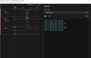

    I checked the I2C bus and I can see that TPS writes 0x6B(write and acknowledged), 0x12(acknowledged), 0x00. After the 0x00 bus halts for 0.8 ms and after that 0x00 command gets acknowledged.
    Then it writes (W = write, a = ack received)
    6BWa, 12a, 00a
    6BWa, 0Fa, 82a
    6BWa, 0Ba, 00a, EAa
    6BWa, 0Da, 17a
    6BWa, 05a, 24a
    6BWa, 06a, 00a, 0Aa
    (200ms delay)
    6BWa, 06a, 00a, F0a
    6BWa, 0Fa, A2a

    I recaptured the I2C bus data when USB-C was plugged in and this is what I got.
    6BWa, 0Fa, 82a
    6BWa, 0Fa, 82a
    (180ms delay)
    6BWa, 12a, 40a
    6BWa,  12a, 40a
    6BWa, 0Ba, 00a, DCa
    (50ms delay)
    6BWa, 12a, 00a
    6BWa, 12a, 00a
    6BWa, 0Fa, 82a
    6BWa, 0Ba, 00a, EAa
    6BWa, 0Da, 17a
    6BWa, 14a, 9Ca
    6BWa, 11a, 00a
    (650ms delay)
    6BWa, 12a, 00a
    6BWa, 12a. 00a
    6BWa, 0Fa, 82a
    6BWa, 0Ba, 00a, EAa
    6BWa, 0Da, 17a
    6BWa, 05a, 24a
    6BWa, 06a, 00a, 0Aa,
    (200ms delay)
    6BWa, 0Fa, A2a
    6BWa, 06a, 00a, F0a
    6BWa, 05a, 2Fa
    // Tomi L

    I tested your configuration on the latest USB-PD-CHG-EVM (TIDA 050047), which uses a TPS25751 and a BQ25798, which is very similar to the 792. It does appear to be negotiating and sinking power correctly. The EVM does not support <8-V battery power so I did test it in a 2s configuration, but this should not change the I2C events.
    Here is a screenshot of the I2C log of the EVM on power up.
    You can see the last 6 writes match the first 6 you shared. Those writes look correct.
    The two additional writes seem strange. How are you powering the system? And is something connected on the type-C port on power up?
    I am testing with nothing on the type-C port and powering on a 4quadrant power supply at the battery terminals to simulate the power on sequence.
    These two writes seem related to a sink attach state (the port is attached as a sink). They might be fine if you are testing with a source attached on the sink port.
    6BWa, 06a, 00a, F0a
    6BWa, 0Fa, A2a
    Regarding sink connection, the writes look a bit different. It seems like there is a detach or reset occurring towards the middle, and then the port negotiates as a sink. The last three writes do seem consistent with a sink contract as they configure the BQ for sinking and set the input voltage and current limits.
    These look correct and I would expect the system to be able to sink current and charge after these I2C messages are sent. What is the behavior of the system at this point? VBUS, PPHV voltages? Charge current and Battery voltage?
    See the expected I2C writes below. In this test, the CHG-EVM was pre-powered, and a USB-C PD source was attached on the Type-C port. The most important writes are the last 3, which are similar to the last 3 you see. Input voltage, Input current, and enabling CHG mode.
    Can you test this sink only configuration and see if you still have issues sinking and charging?

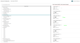

    Can you try this json for 5V sourcing? Your original config attempts to swap to the PP3 path for 5V sourcing, which is likely why you see it for 5-V temporarily, then it fails. I changed the configuration to source 5V through PP5V, so it should be more stable now. This should be based off of the config you sent yesterday.

    This solved the sourcing issue. Thank you very much for your help!
    So the issue in my config was the bits 9-8 in register 0x32 I believe. Strange that configurator sets it to PP_EXT1 even though I did select the correct looking option.
    Configuration selection
    I did notice some other changes also, but I believe the above was the crucial one.
    So the system now charges the battery and sources for current for load. How ever I did connect my phone to it and system started sink current from phone and I was hoping to use this to charge my phone. Do I need to change this setting with microcontroller by changing register values on the fly or is there still some other setting that I am missin?
    Thank you,
    // Tomi L
  • Hi Tomi,
    Glad I could help.
    The preferred power role question(Q4) determines the role that the port will try to end as. Because phones are DRP, and your preferred role is "Power Sink", the TPS25751 will attempt to become the sink through PR_SWAP (power role swap) requests.
    This bit being set does not guarantee that the port will end as sink, as some far-end devices will either reject or not support power role swaps. (i.e. if a USB PD sink only device is attached, the TPS25751 might still send the PR SWAP to sink, but the sink only device will reject the swap)
    If you want the port to prefer the source role, you can select the "Power source" option.
    This Question is primarily configuring the "Initiate Swap to ...." bitfields in the port control register. If you do not want to prefer a power role, there is not questionnaire option, but you can manually go into the "Advanced Mode" part of the GUI and de-select both.
    Never have both "Initiate swap to [power role]" settings selected as it can cause an infinite loop of power role swaps.
    Thanks and Regards,
    Chris
  • Hi Chris,
    Thank you for clarifying the behavior. I now understand how this should work. And Thanks again for your help.
    Tomi L
  • Hi Tomi,
    Glad I could help. Closing this thread now. Feel free to re-open this thread if you have related questions, or open a new thread.
    Thanks and Regards,
    Chris
