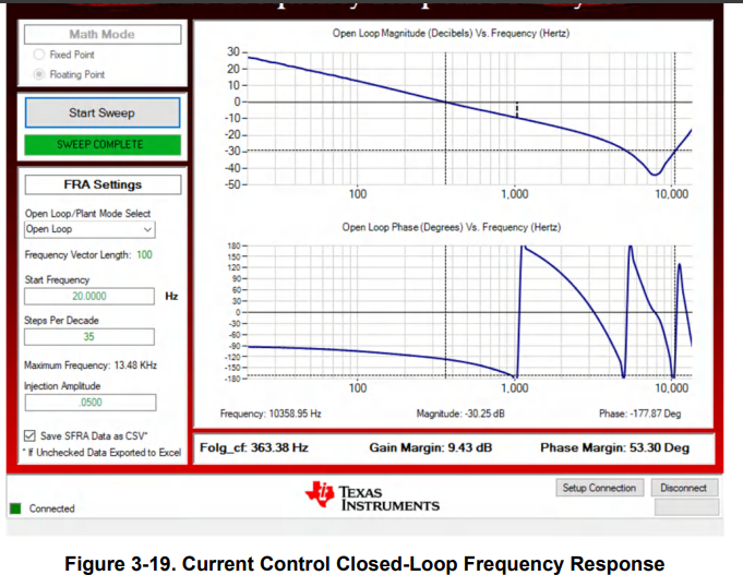

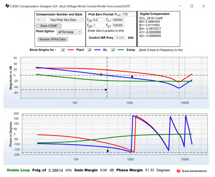

    15.625kHz is ADC data rate. We are using a digital compensator. The digital compensator runs at the ADC data rate. You needs this to calculate coefficients for 2P2Z compensator. The compensator tuned frequency is 400Hz. At the 400Hz, OL plot(blue) becomes 0dB. See the below pictures. First picture shows compensator designer result. Second picture shows SFRA result for using designed compensation values in the c2000 firmware. Both show same result, 400Hz.
    I'm not familar with sisotool in MATLAB. What I understood, in your MATLAB example, you have a transfer function. You don't need to convert this to discrete domain. You can design an analog compensator first. If the analog compensator satisfies your requirements, you can find out the digital compensator values by using compensator sample rate, which is same as 15.625kHz. You don't need to use switching frequency.
    Your last question is should bode plot include compensator response? Yes. In the closed loop system, we study phase and gain margin of the loop gain. Loop gain is multiplication of all gains in the loop. This means that you need to use multiply plant response with compensator response to obtain the phase margin and zero crossover frequency.

    Calculated bode response
    Zero crossover frequency: 386Hz
    Measured bode response:
    Zero crossover frequency: 363Hz
    Shaury
