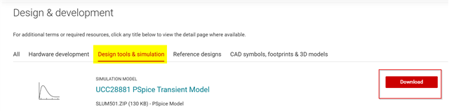

Step 2: Click on “Design tools and Simulation” and hit “Download” as shown in image below.
